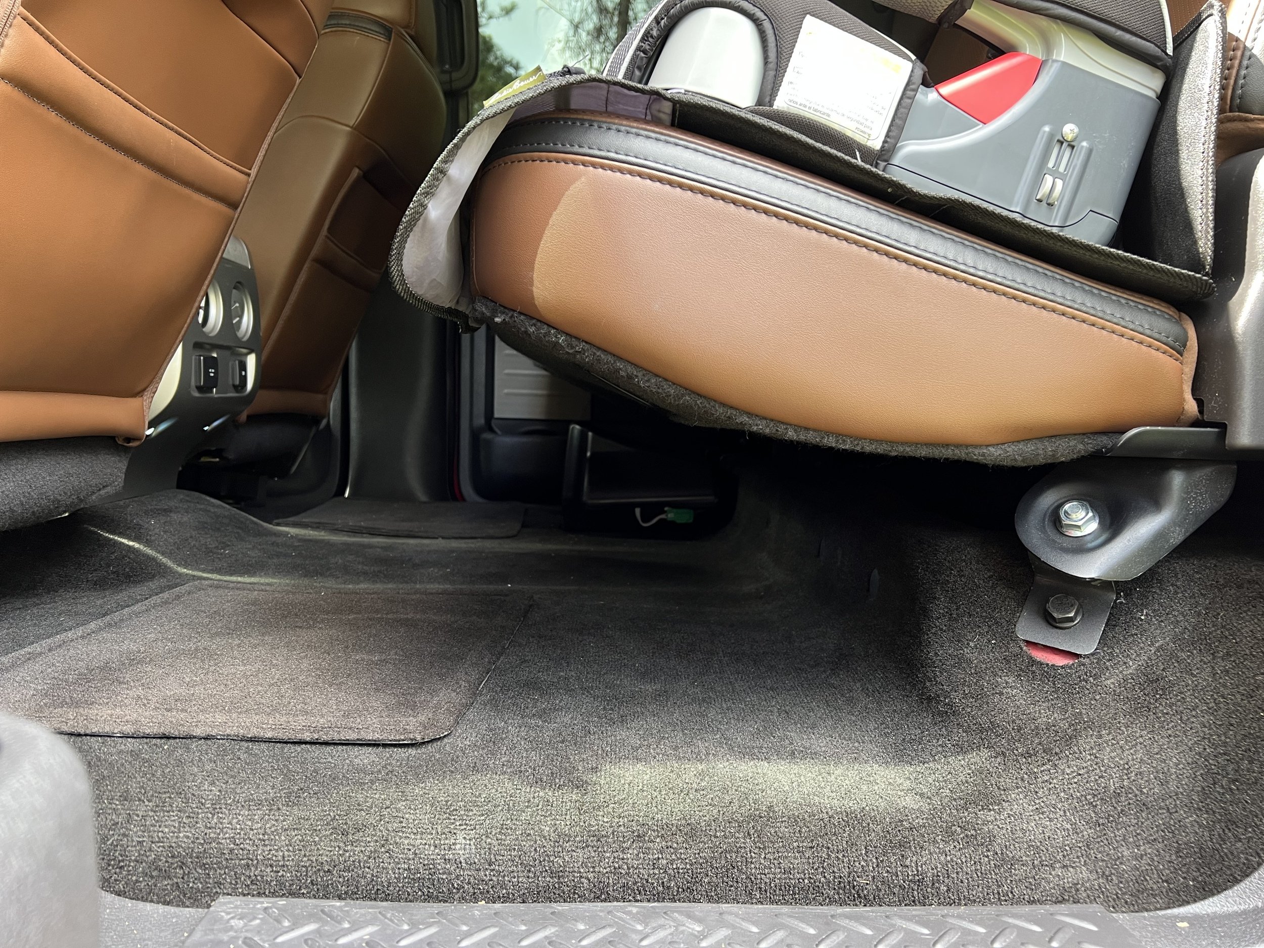

I picked up a ‘14 F150 and installed the 2.5” rear seat lift yesterday. Now I just have to decide on what subs to run and how to place them. I can do 10s front firing or up to a 12 down firing with a 6.5” or smaller mounting depth. I’ve read the port should face out one of the sides, but what’s the best option for the sub? Front or down?

I’ll put the amp behind the seat. Under I’ll have 55” wide 11.25” height front / 8.25” height back and 13” deep. I want to go SQ. I’m looking at 1 or 2 W6 10s front firing since they don’t need much space. 1 Image Dynamics IDQ 12 down firing. 1 IA Flatlyne 12 down firing. Are Soundqubed subs SQ? I listen to mostly hip hop, and most of it I screw and chop.
