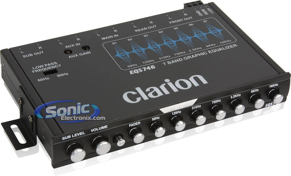

clarion EQS746 Plug the single RCA input you have into the "main in" part of the EQ you will get front out, rear out, sub out, now you have 6 pairs of RCAs to play with along with some sound adjustments and a bass knob. Limited but still useful subwoofer crossovers too.
Amazon.com : Clarion EQS746 1/2 DIN Graphic Equalizer with Built-in Crossover : Vehicle Equalizers : Car Electronics
