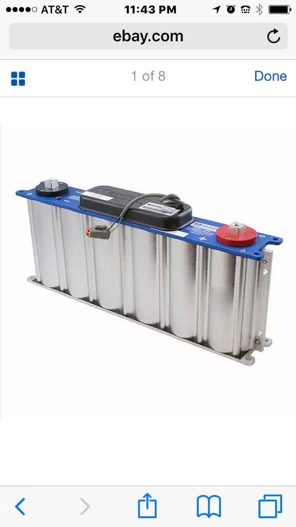

Id like new. I see these.
Im assuming these are best for my needs. ? Good price or can anyone due better lol. Thamks
Nothing just saying its a good price for new ? I got new for 15.00 less a bank but didnt come with straps and they were 15 for two sets so almost the same price. I am not familiar with the connections on those caps ? Mine have threaded studs coming out of them, Maybe there internally threaded so you screw bolts into them ? That would be cool make them a little smaller. You understand you will need to put them into something because those straps will be hot when hooked up ? I built a plywood box and glued cc foam on the inside of the box to protect them a little too.
