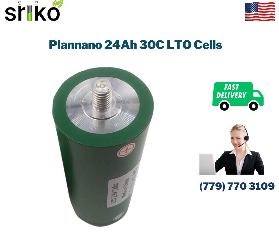

I love my Yinlong but if I were to buy now I would do Plannano.
Those are good cells be sure to find a bus bar maker before ordering. They should have several options by now other than diy. Even sirko cells bus bars now. Nothing fancy but they work

They are 2.3 volt cells. You would need 6 in series for a single bank of 24ah.
The Yinlongs are 40ah but 10C where these Plannanos are 24ah and 30C.
Damn, that explains why the Plannanos are hot right now.
