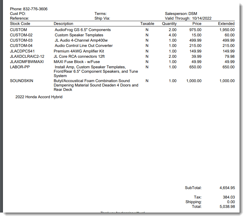

This is all great info, thanks everyone. Honestly, I'm not doing the install myself, I don't have the knowledge or the time but the shop seems respectable. This is what I was quoted
43741

Personally I wouldn't do rear door speakers. Or I would just do coax or just midrange speakers. The rear tweeters will drag your sound stage rearward.
ok, looking at the proposed system it seems to me that it’s a lot of money for what is, in essence, a very simple setup. The quote is very vague as to exactly which JL Audio amp they are referring to, but the fact that it‘s said to be four channel and they have quoted for two sets of Audiofrog speakers suggest they intend to use the passive crossovers the speakers come with and no DSP. Also, there’s no subwoofer! This certainly isn’t the way I would spend that much money. A car is a truly terrible environment for speakers and DSP is really a godsend in terms of integrating drivers for optimum results. First and second order passive crossovers have no chance. I would also question the need for such expensive speakers in the back - in fact I think far too much is being budgeted on the speakers in general. Personally, I would expect a fully active system for that money and I would spend less on the speakers. Audiofrog seem to have a great reputation but in terms of technical sophistication they are nothing special (though that doesn’t mean they don’t sound great).
