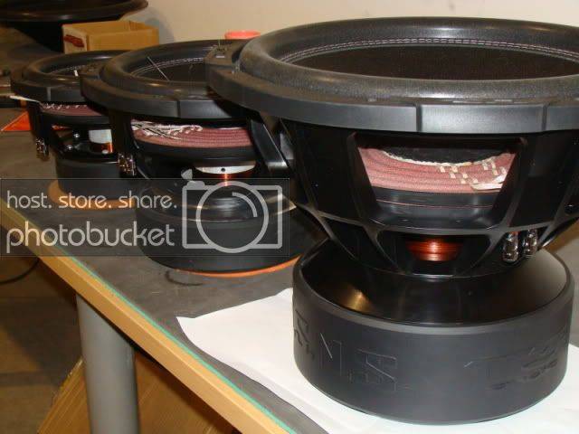

I don't know how much these costs but they all look **** beefy
Crossfire XS SPL v2
T3 Audio TSNS
