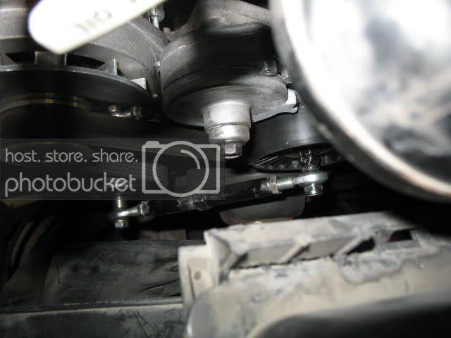

I had to go back to a full size pulley (not as much output at idle, but helps the slip with more belt contact area), use a shorter goodyear belt, and do this:
