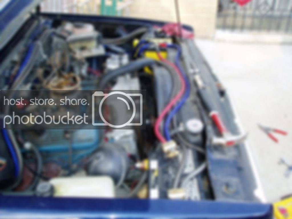

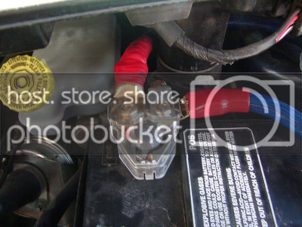

I used the regular style terminals that you can get at autozone when I had my top post batteries. Normally they hold 2 4 gauge wires and 2 8 gauge wires. I just drilled them out to accept two 1/0 and two 4 gauge.
Here's a pic.

Im liking TommyKs so far, but i dont like modding stuff if i just buy something diff
