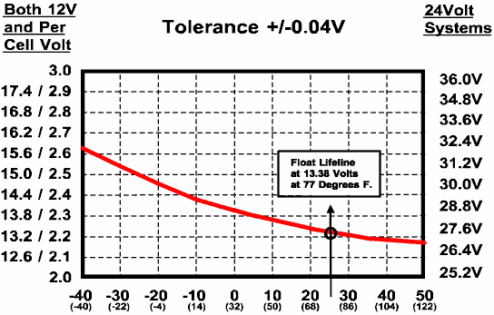

temperature is definatly going to effect a battery i couldnt really find a good chart off the top of my head but here are some
cool, I had a feeling that might be affecting it. i'll have to try and let my car sit for a day in the heated garage and see if it makes any difference. the battery still had a light layer of frost over it after sitting with the trunk open and charging for 4 hours
