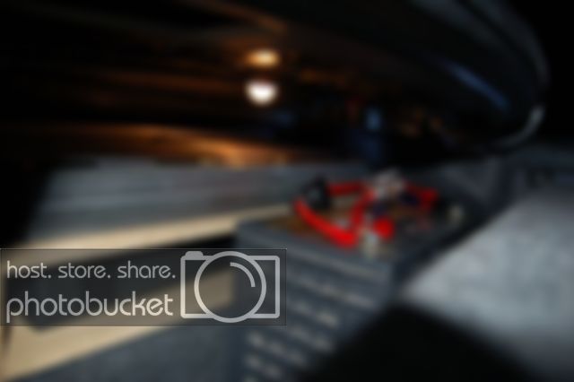

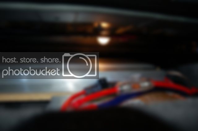

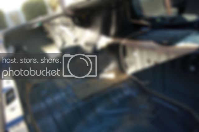

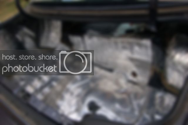

Pics tomorrow. Bought a ton of ring terminals + 2 fuse holders today so I can install this monster. Let me clean up all my wiring under the hood and get all of this installed, then pics. Dont want to look like a huge noob.. but you may still see my ghetto particle board amp rack.

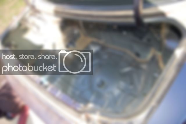

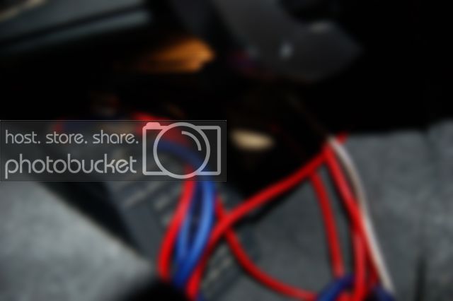

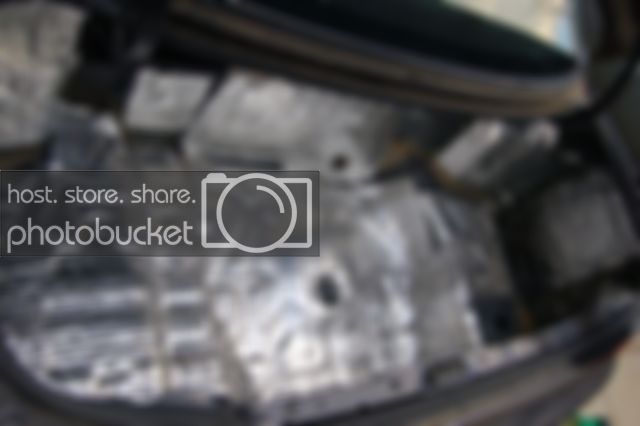

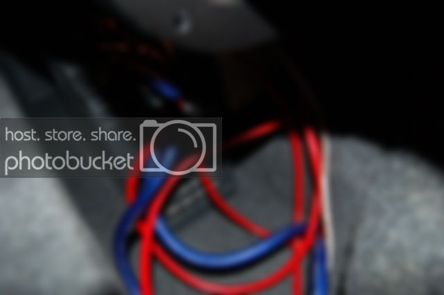

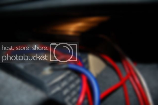

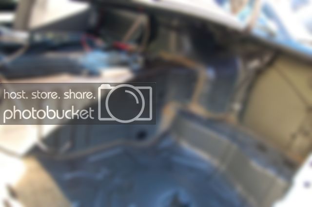

Theres a few pictures. Nothing amazing, its dark outside.
