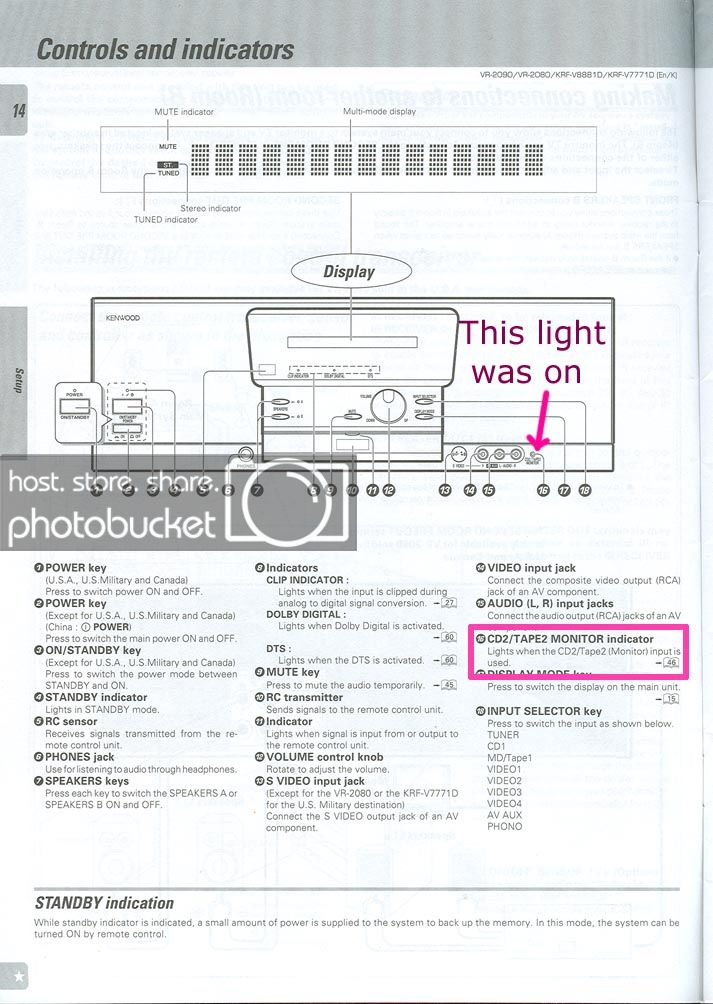

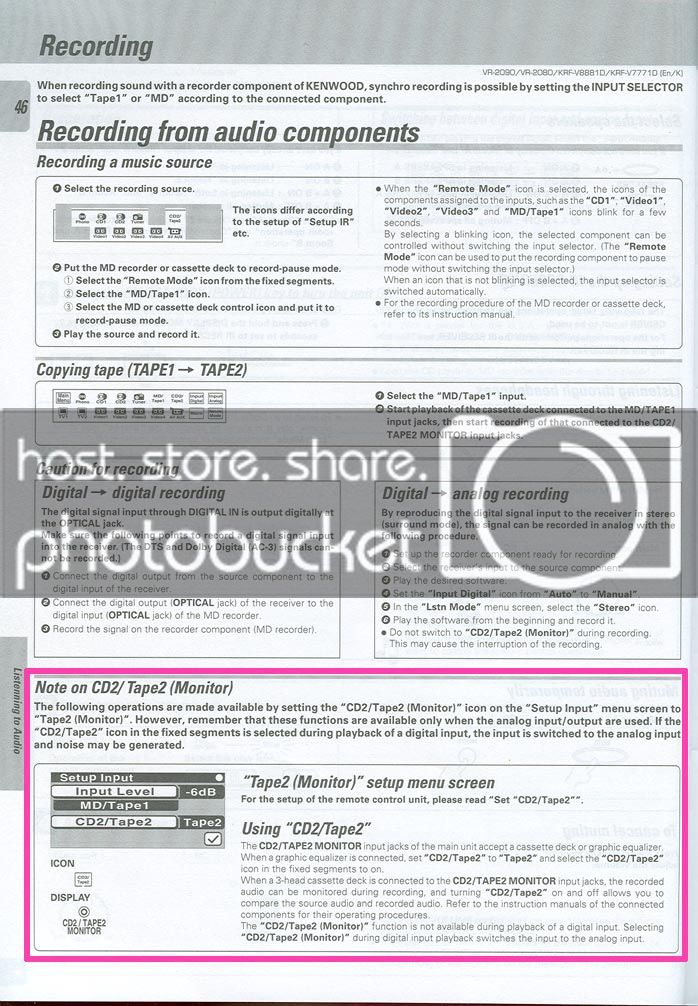

This is probably obvious and you probly checked it but im just making sure...
most recievers have a wierd "Tape" button and if its pushed it will make the reciever have barely any sound come out.. and usually a "tape 1"
light or something is lit. I do that one in a wile with a kenwood at my house and it always gets me..
I noticed the light on in the front of the unit. I figured what is this? I luckily had the owner's manual. It said something about a tape monitor. All I did was go in the remote, choose Tape 2 as the input, and the sound reappeared. Odd
Thanks to all who helped!
