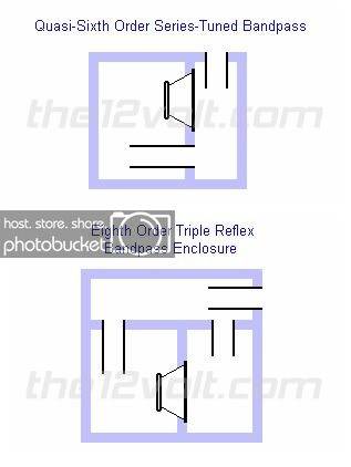

im looking to build an eigth order triple reflex box and i dont know how to tune or anything like that so im looking to the pros for help thanks

if u going to use that sub be prepared to build a 7cube box and thats internal air space after ports and sub displacement
i would suggest a 6th order parallel tuned box its less complicated and smaller than a 8th order

how big would 6th order be?
man, I would not suggest anything higher then a 4th order box. you are going to be very limited on the output or freq responce if you do anything more then that.
If you want some help on a 4th oder I can help you with a design based on your driver.
Read up on the 6th-Higher purposes, If your wanting to actually listen to any full range of music they are not what you want.
