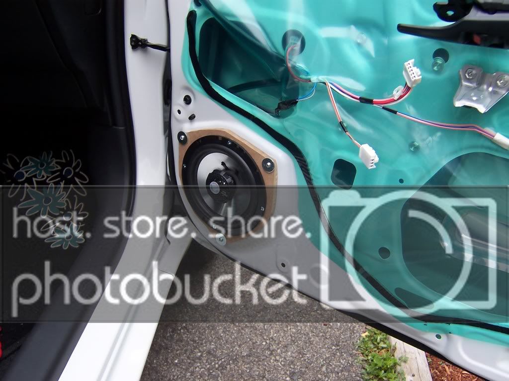

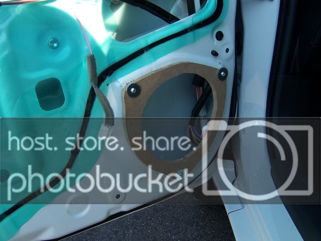

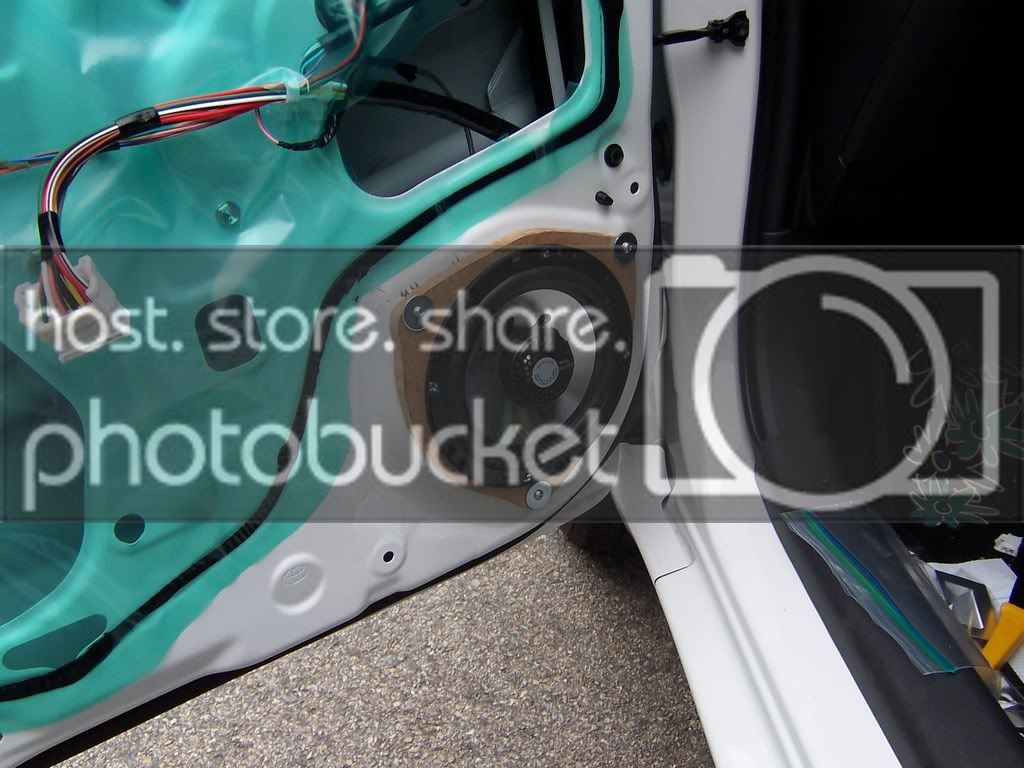

alright.. this is in an 08 scion xd i did a simple install on a month or two back...
the speakers were in baffles, all one piece, riveted to the door. no screws, nothing. i had to drill the rivets out, took the speakers out, in their baffles, but now theres a hole too big to fit the speaker. what to do??
make the shape out of mdf, fasten it to the door, screw the speaker into the baffle...
there you go... you can follow the same procedure.. make a cutout in cardboard, find hole you can mount to (make sure you have access through the backside) and trace it onto mdf... cut out... fasten, screw!
