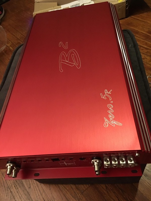

B2 make new product lines every other year it's hard to keep up. By the time you save up the money for it, it's already discontinued and the price keeps going up lol. I got my zero.5r 3 years ago brand new for $1000 and now they have the updated version which is the zero 5 falcon for $1400 on skyhigh
here's a pic of my zero.5r for my upcoming build

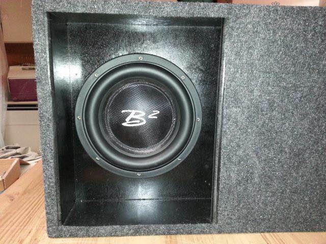

@Cynic0l I'm currently running an older 10" B2 Ref in a T-line with a B2 Mono V4 amp. It's their Sq line and it gets loud easily without much power.

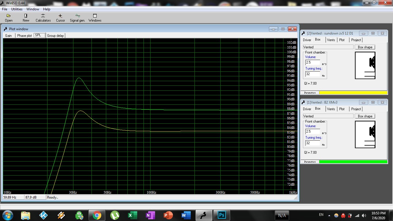

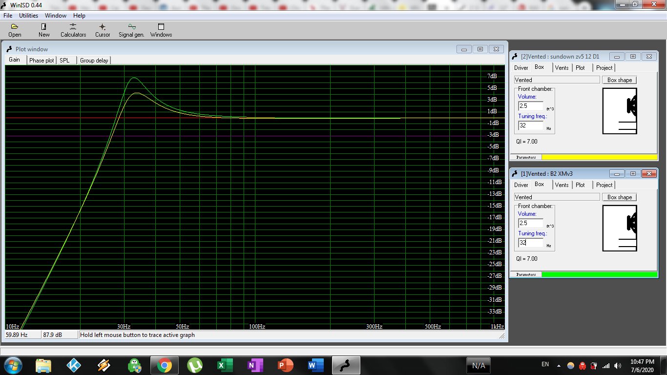

Well we all know sundown's reputation around here but B2 makes beefy subs as well.
Take a look at the B2 Rampage XMv3
Same price range and when I compare them side by side, the B2 sub looks like it's going to be louder on paper.
zv5 has a 3" coil with 35mm xmax and xmv3 has 4" coil with 40mm xmax.
Here's a graph comparison using the same exact box. Yellow is sundown and green is B2

Tired as hell from work lol promise I’ll never be this lazy and stupid again to just compare the specs. Just Like getting input from guys who know what they’re talking about. Thank you!!
