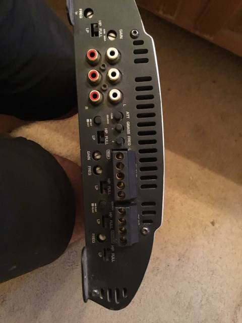

I'm going to be running an old school Precision Power Pcx4125 1000 watt 4 channel (I hear amps don't get much better, been sitting on it for 12 years just waiting for the right time)...

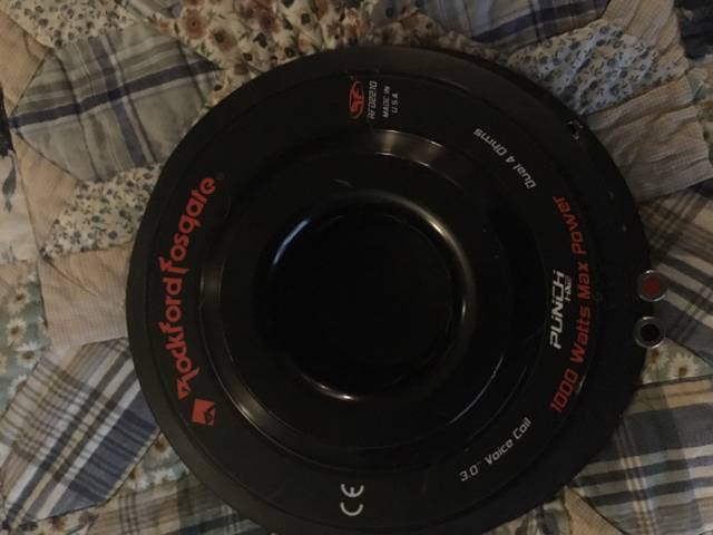

My first question is: If I run my front component speakers on the front channel, will bridging the other channel give me enough power to get good sound out of 2 Rockford Fosgate HX2 1000 watt dual voice 10s (more candy I've been hoarding for over a decade) and if so, how would I wire those 10s?
Are the xovers on a quality amp like this ppi (and xovers in components) sufficient to not necessarily need active xovers?

My opinion for what you call sound quality and correctness. Use the ppi 4 channel to run your mids and tweets and get a proper class d amp for your subs. By proper I mean one that has more than enough rms power to run them.
Thanks... since I'm not going be running amplification on rear channels, just seems like such a waste on such an awesome amp, 2 only be running 2 channels... is what it is though...
If I were to run it as I stated, would I be better served to only use one of the 10s? I know that's a waste too, but hypothetically would I be better off running one?

Also, in your opinion, with the crossovers on this amp (which I assume would be relatively top of the line as far as amp crossovers go) and the crossover that came with my components, is there really any need for dedicated active crossover?

See if you can find another ppi pcx 2 channel for the subs.The crossovers today are MUCH better.
If it were you, would you just run the ppi 4 channel I have on the subs only, and get a "lesser amp" for components?

Id run that amp on the subs only..They will prob only handle approx 3-500 rms in the correct enclosure/enclosures. Id pick up a two or 4 ch to run your front stage with a little better x over settings if running active.I have 3 of those type amps /smaller sitting if you want keep all PPI..Ive got two PC250s and one PC275,and two PPI additions blue and pretty clean..Special Editions A2050, and A2075..Straight old school clean amps.Be nice to run an EQ to be able to clean up any song/music at your fingertips..Thats me,rather than playing around going through the HU all the time.I like rear fill.Doesnt take much to keep those running clean and clear on about 40 rms and gives you that surround sound affect.Center stage is nice to have as well as long as its not over powering your front stage from the doors, again 20-50 rms.Deff going to need to get your electrical to sustain the needs as most newer vehicles seem to rob power from here and there to supply electrical needs,and or place just enough to meet basic requirements to pass QC.What speakers are you wanting to use up front?Stock? All Stock except the subs?
