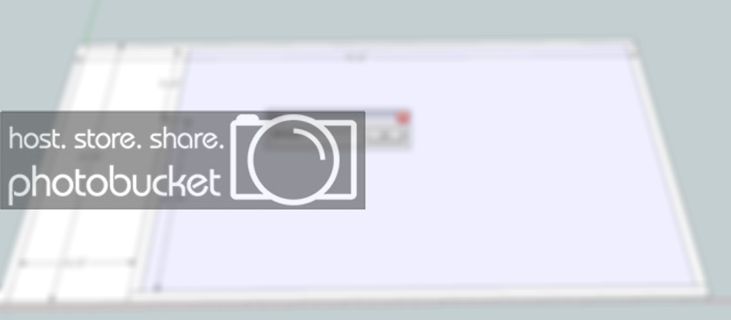

What you guys are forgetting to do is account for the corner of the box as it becomes part of the port. Why don't you tell me the volume of this pic it is his dimensions all you have to do is multiply the area by internal height and you have internal volume.

you just proved to the world that you don't know what you're talking about. so you telling me and this forum that the space behind the port is considered part of the port and should not be taken into account for the box's internal volume?
you account for the port after gross volume. vb of a box is after port and subs not before. so i didnt "forget" anything at all and i think fasfocus already said the measurement dimensions, i didnt verify it because I know he has been around long enough to do the simpl math required. if you want me to really do that i would be happy to

You might as well finish what you started and visually move it to the middle for me?//content.invisioncic.com/y282845/emoticons/biggrin.gif.d71a5d36fcbab170f2364c9f2e3946cb.gif
