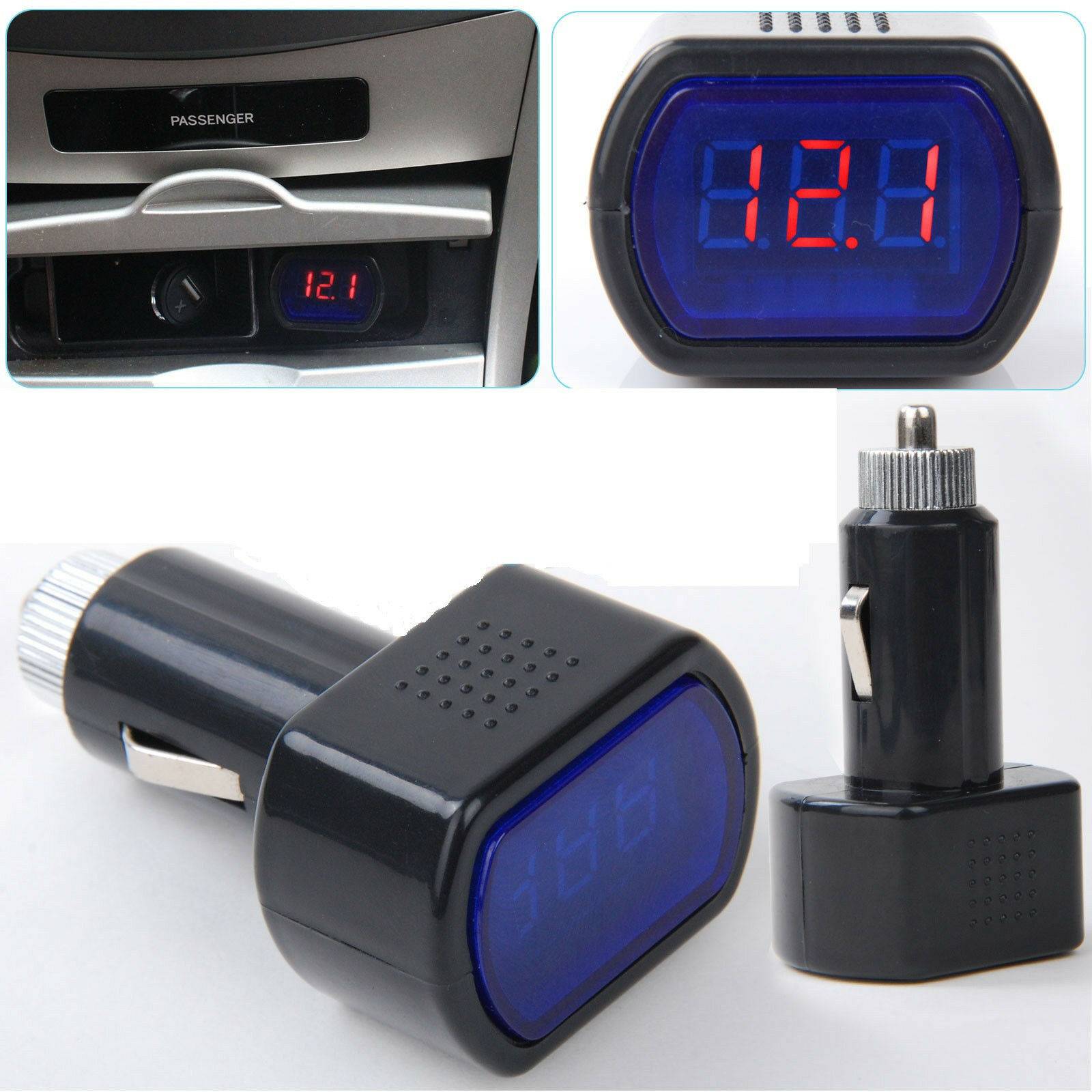

I say put one of these $4 voltage meters in your cigarette lighter outlet and monitor it for a couple days when you're driving around. It should be wired to your 12v battery up front, and you'll be able to tell if the battery is maintained off your hybrid's high voltage battery or if the engine cycles on and off to maintain it sufficiently.
Digital LED Auto Car Cigarette Lighter Volt Voltage Gauge Meter Monitor 12V/24V
