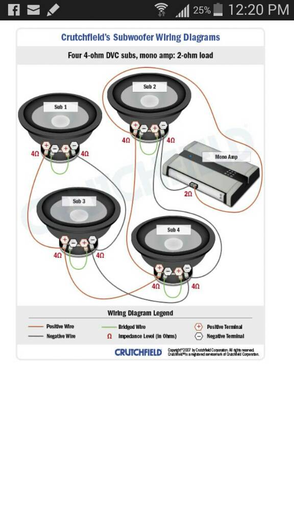

So I bought a Kicker ZX 1000.1 and acquired 4 Kicker L7 8" 4ohm DVC subs. My issue is the amp needs a 2ohm load to make the 1000 watts and I really don't want to install all 4 of those subs; not to mention that if I did it will only be putting out 250watts to each sub which are rated at 450watts each. Also I wanted a smaller system to fit the car so I was shooting for two. What config do you guys think would sound the best 1,2,3, or all four? Any thoughts would be much appreciated!!

Run all 4 for a 2 ohm load.

250 will move them fine. The sheer amount of cone area would make up for the difference. Just make a custom ported box big enough for them to properly work. They need like 1 cubic NET each that means the airspace remaining after subtracting the space the port and subs take up.
