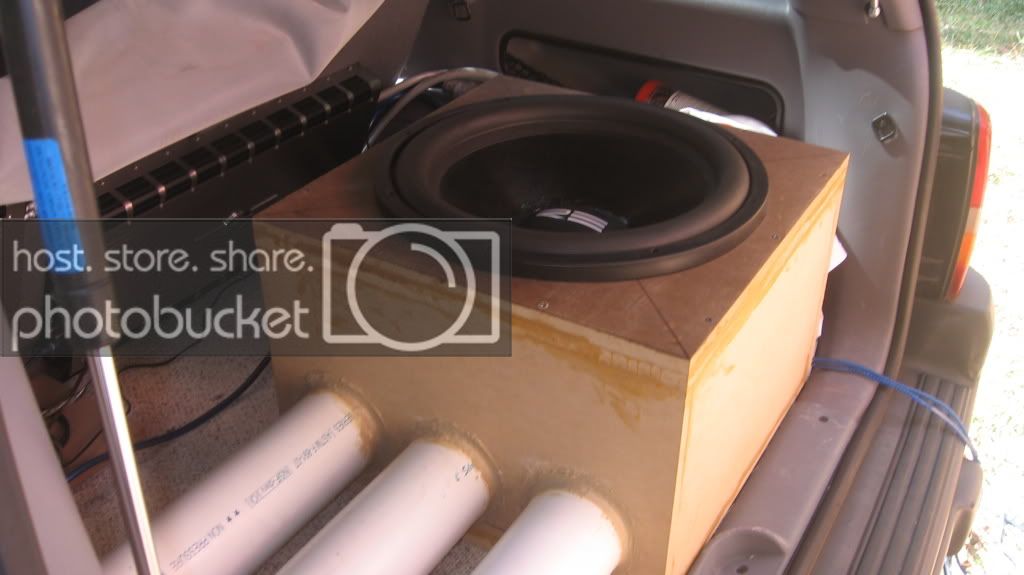

does 150's all day long. i attached the ports with liquid nails

if you just sand the edges smooth, and have close to the recommended port area, you'll have no problem. Using 4" thin wall pvc and elbows makes using round ports a lot cheaper. I used liquid nails to attach mine in my new box, works great.
