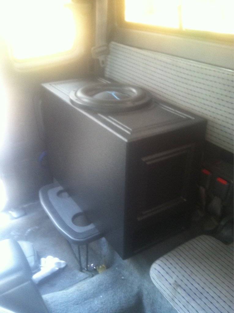

No 3rd door is drivers side. Love that box tho.....did you ever finish it?
No I haven't but it does smash the lows super impressed with the 8s output but the one still has crazy spider slap I took all the screws out of the ring and pryd it up and re epoxied it down but still didn't fix it so its gonna need a recone when I got time and money for it I'll just play it the way it is and hope I don't damage anything

Ugly setup i know //content.invisioncic.com/y282845/emoticons/biggrin.gif.d71a5d36fcbab170f2364c9f2e3946cb.gif it was a temp setup with boomsday box. Sub up port facing driver wall.
Higher frequency 38-45hz which is my trucks resonance frequency.. This tiny box would give you slight choke feeling on just 2k watts.

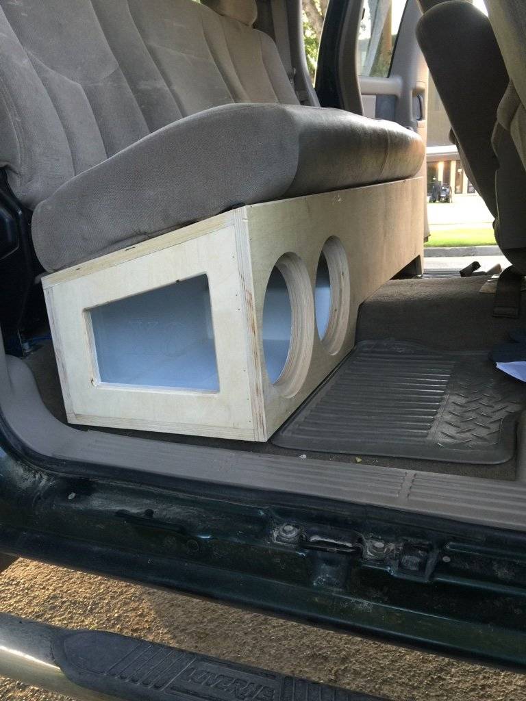

I have quite a few under bench as well as with the bench removed. What are your max dimensions to work with? 2 8's in a tline is quite possible. I'm going to do one for 2 DC m8's next week that's 48x12x14.
