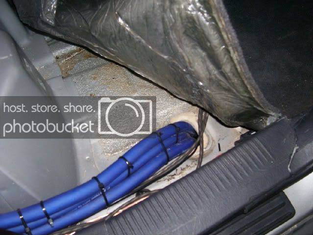

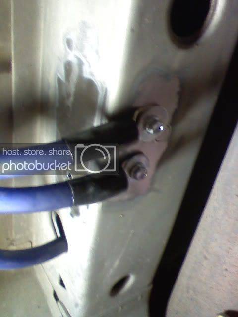

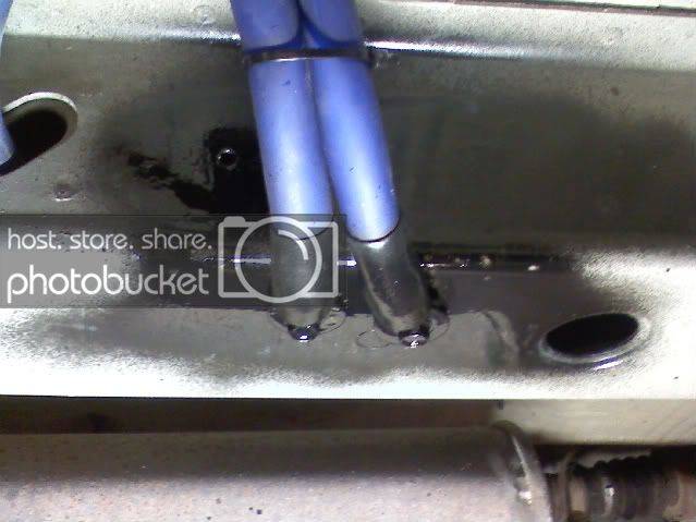

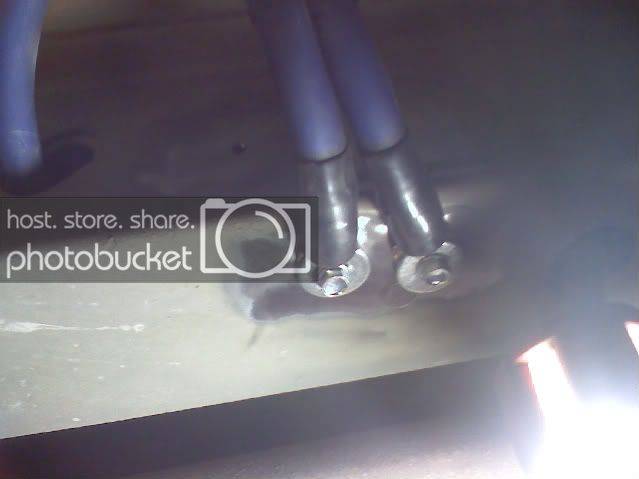

Lift up your carpet near where the rear seats attach at the bottom...there should be some type of grommet somewhere, just run some 1/0 thru it and go directly to the frame. Thats exactly what I did on my jeep. Its a 2000 grand cherokee however...but here are some pics of my grounds.
