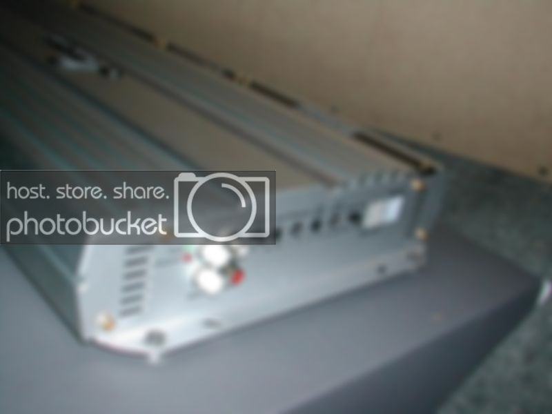

This is the first box I used vinyl on, so the edges are pretty crappy. The box overall looks pretty good. You can see I also put vinyl on the amp rack.
If you put a little thought into where the seams end up, you can make a great looking box. I used 3M Super-70 spray adhesive.
