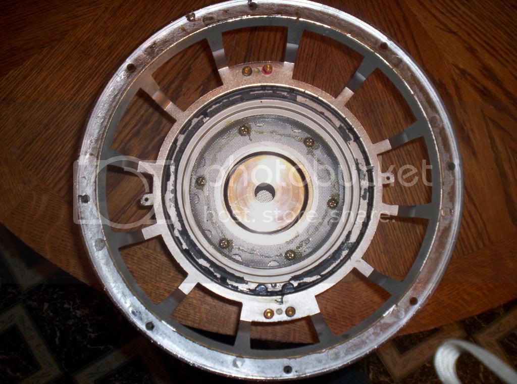

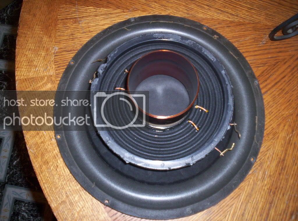

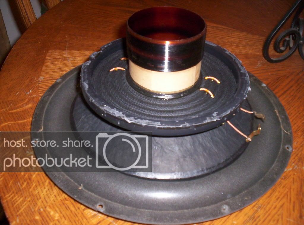

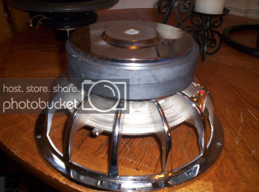

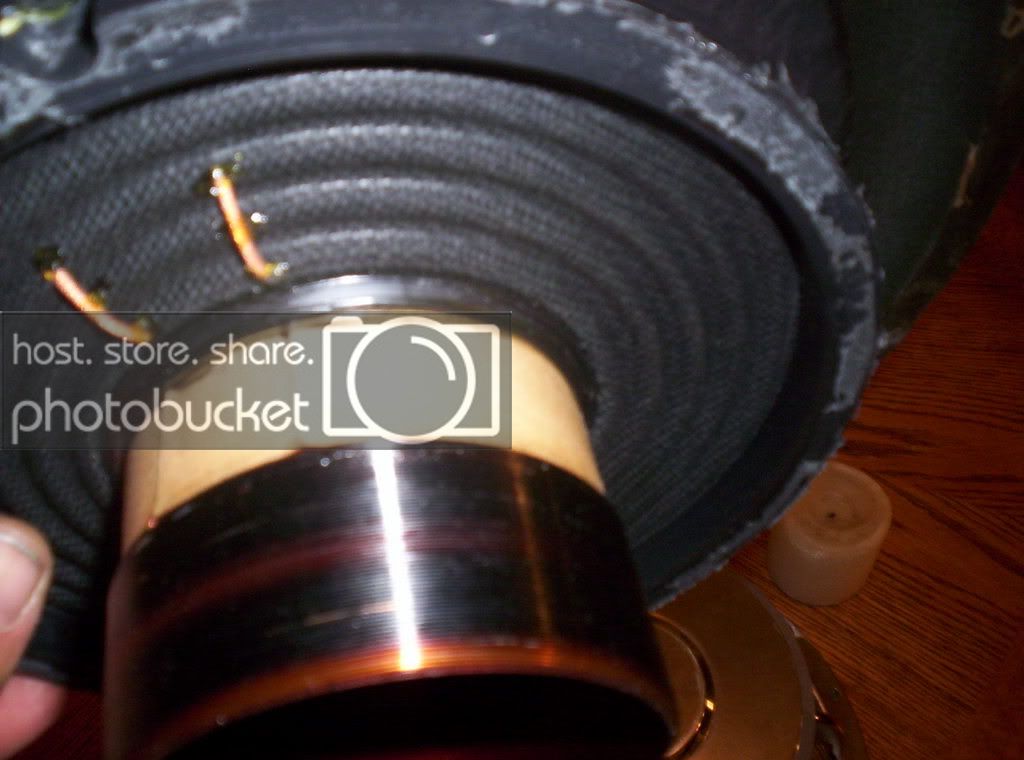

Yeah but if I buy a good recone, I know it will be good. If anybody is curious here are some disceted(?) pics
