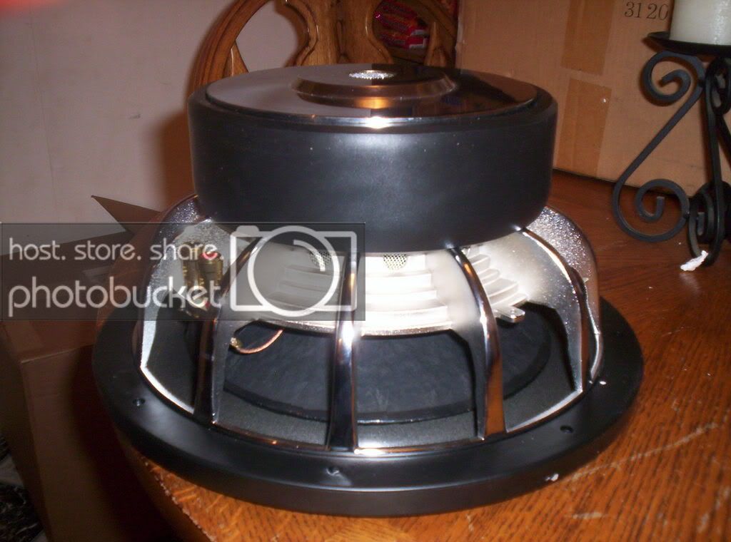

Those are the pics off of ebay. I should recieve the subs on Wednesday. When I get them I will take more pics. I talked to the seller and he said these were from some company in China that was starting their own subwoofer line, but never made it, and these were seized property from us customs. I have no idea what they are, but it looks like I have the only ones!!//content.invisioncic.com/y282845/emoticons/biggrin.gif.d71a5d36fcbab170f2364c9f2e3946cb.gif

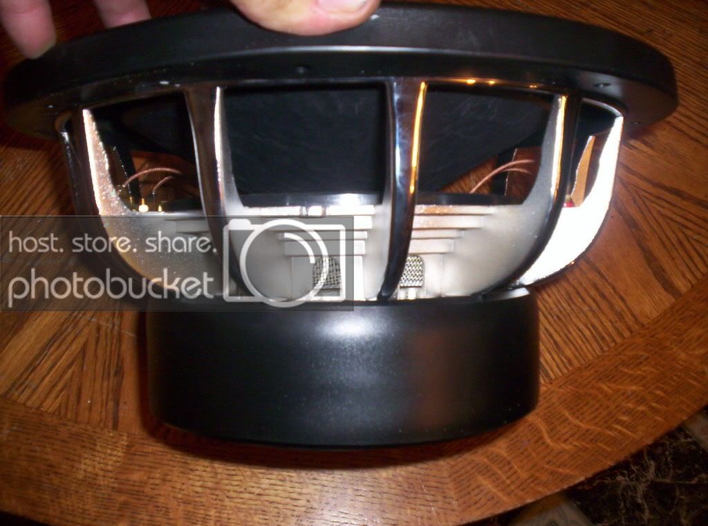

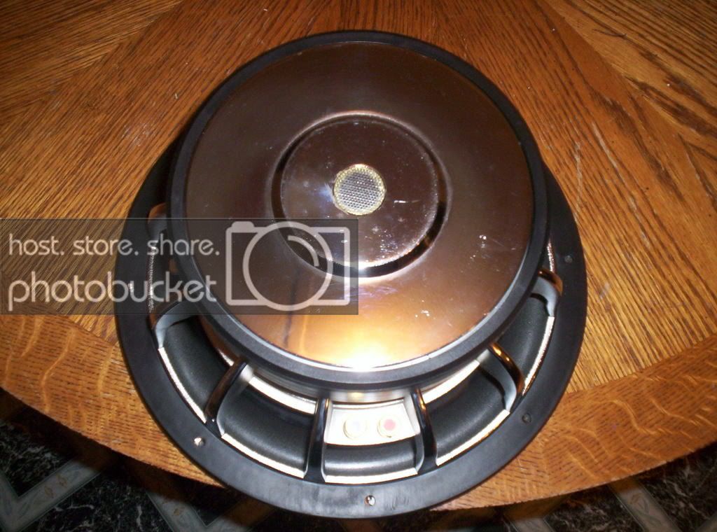

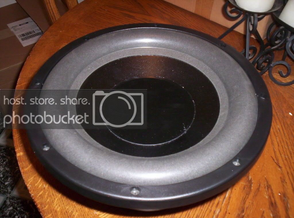

Got these things in today. Man are they beasts. 20 lb. motor. They are heavy as hell. It's got one heck of a suspension on it. Take both hands to push the cone in just a little. I hope my 800 watts is enough for both of these. Anyways here are some more pics. Plan on building a box this weekend to test these baby's out. Definatly not bad for the $20 a piece I paid for them!
wow, thoes look meaty...
be sure to post pics and review when you're done
Nice Find //content.invisioncic.com/y282845/emoticons/smile.gif.1ebc41e1811405b213edfc4622c41e27.gif
