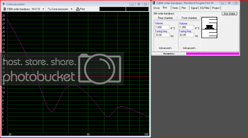

Its a 6th order designed by Jud "Fallen" T. over at ROE. Mounting hole for the sub is about 235mm or about 9.25". Here is a bit of the email describing the box from him before I built it:
the box is 1cuft tuned to 33Hz and 1cuft tuned to 63Hz. Port velocity is below 17m/s from 30-70Hz, there should be no chuffing(with 1kW)
Excursion is good from 30-70Hz. I included the graph so you can see exactly what its doing at what frequency(with 1kW)

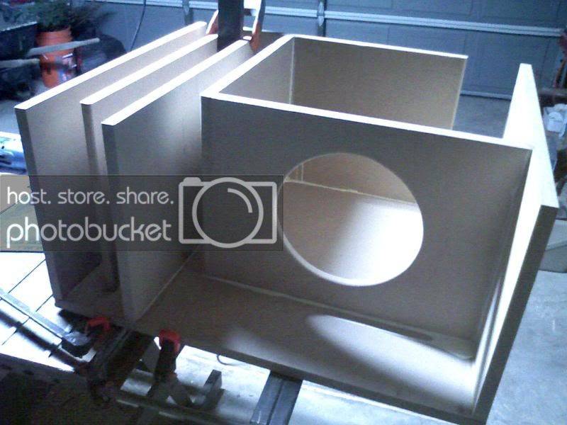

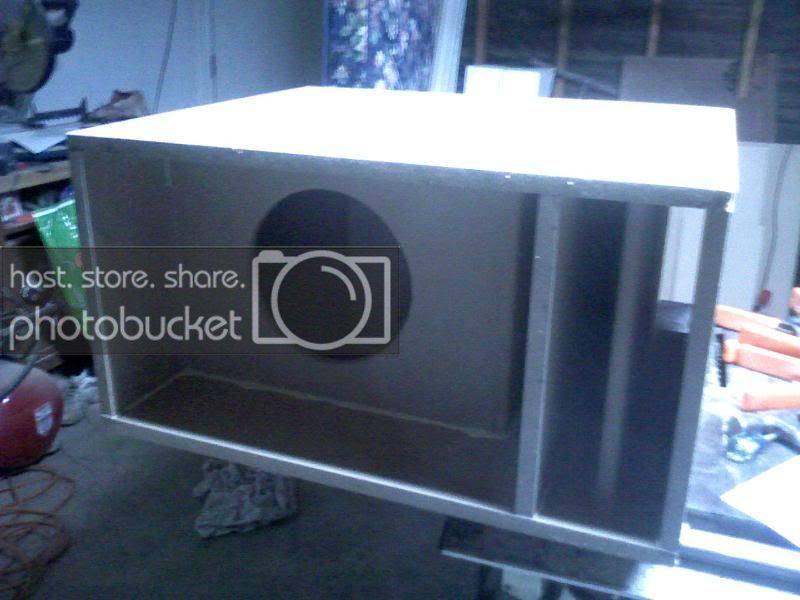

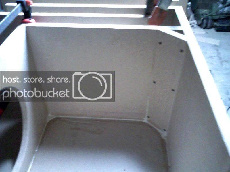

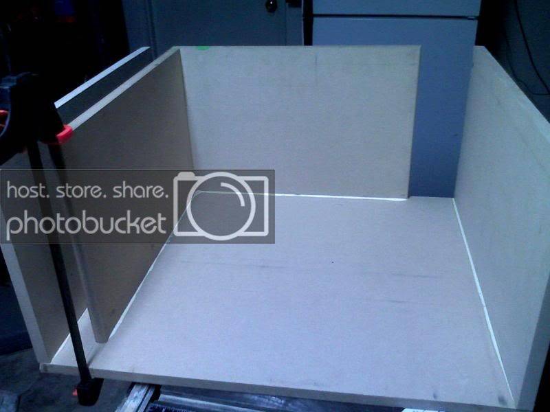

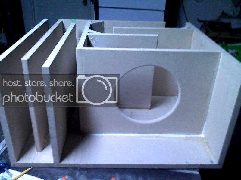

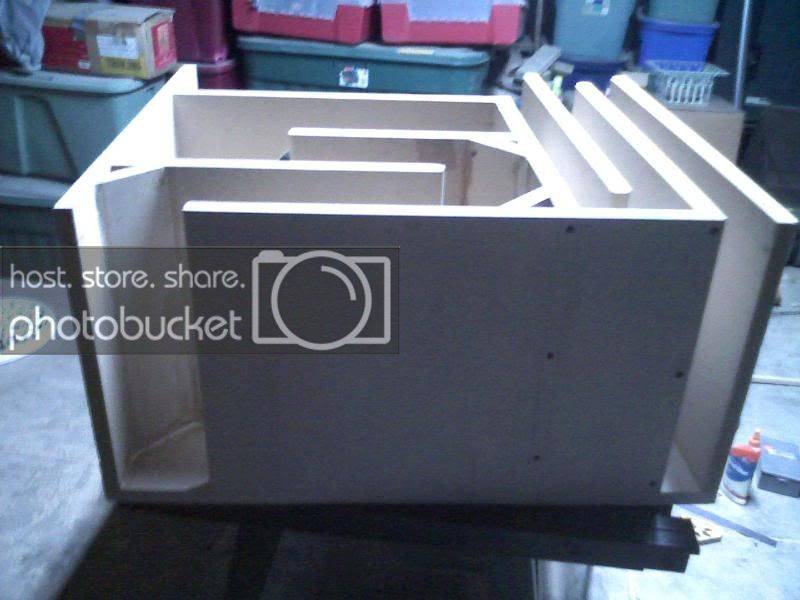

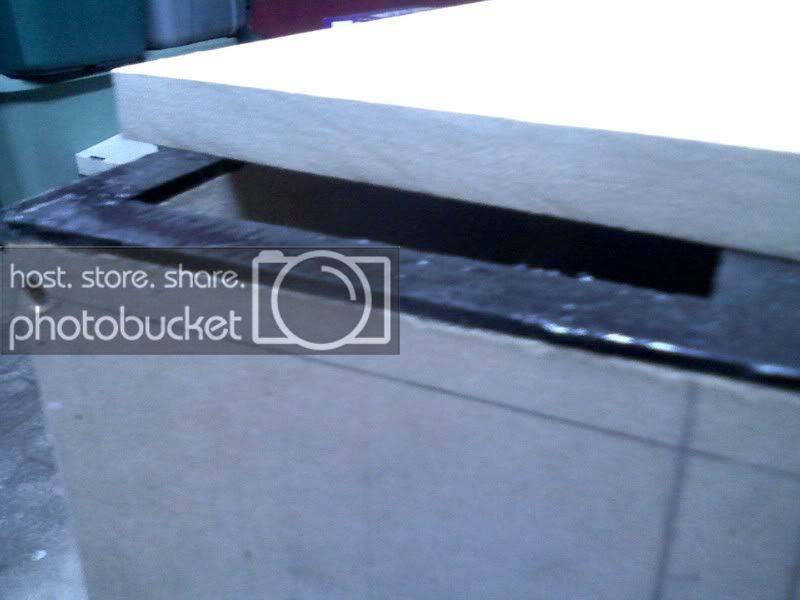

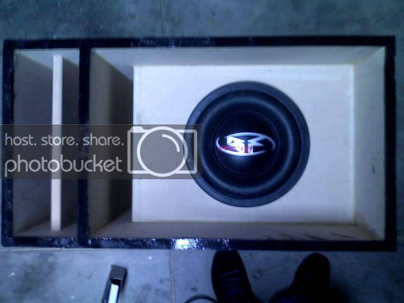

It has very nice output just as the email described. Here are pictures of the actual build:
If you're interested, send me a PM with your offer, otherwise it's $1,000,000 OBO. Box size is 15"h x 27.75"w x 24"d. I did not measure the weight so your guess is as good as mine in that respect. Note that you'll have to pay for shipping unless you want to come and pick it up if you're near 93625. Thanks for looking.

You should stick a pic of WinISD Pro Alpha with the freq response plot, the Cone Excursion plots are seldom right, especially if the parameters are "Paralleled Coils". Freq plot or full sub parameters (which im curious as to how they were acquired) would def make me consider making an offer, Plexi would only be around $70 and I'd do that with no argue, lol.
lol, I just sold an LMS 4K 10, lol Q on the LMS is a lil high for a 6th order anywho. I've got a 10 that would work, A Qts of.3 and a 1w/1m of 89dB. 600 rms with an Fs arond 31Hz, the same size front and rear chambers worry me, should be higher gain on one side and that would prevent the flat response proper 6th's are known for.
The regular version doesn't show cone excursion? at least mine doesn't. lol. I run ISD Beta and Pro ALpha, on my alpha will estimate cone excursion.
Woops turned out I had alpha already. The graph in the first post is from the man that designed the box. I started to enter the parameters from BB6 to winISD but it wouldn't let me save them. I'll have to get the book that came with the sub and enter the 'for sure' knowns, then let ISD calculate the rest.
Which plots would you like to see? Or did you want me to enter the parameters from the sub you have in mind with the measurements I have?
