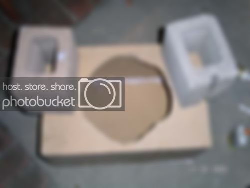

Another Mach Box Build *pics*

I got the design for a t-line laid out. 90.6 inches in length, 80 in^2 port area. Dimensions of the box are 22.5"w x 20"l x 16"h . Port is 16" x 5". The port will have 4 folds. Just by these figures does it seem right?
This is for a single 12 with an FS of 37.4
