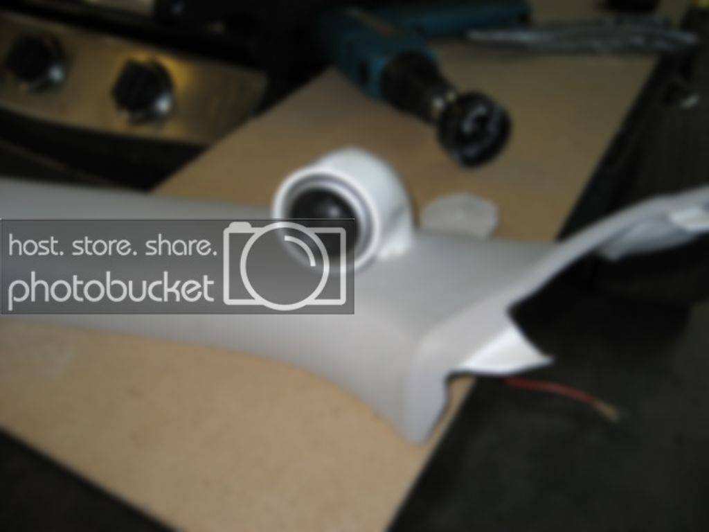

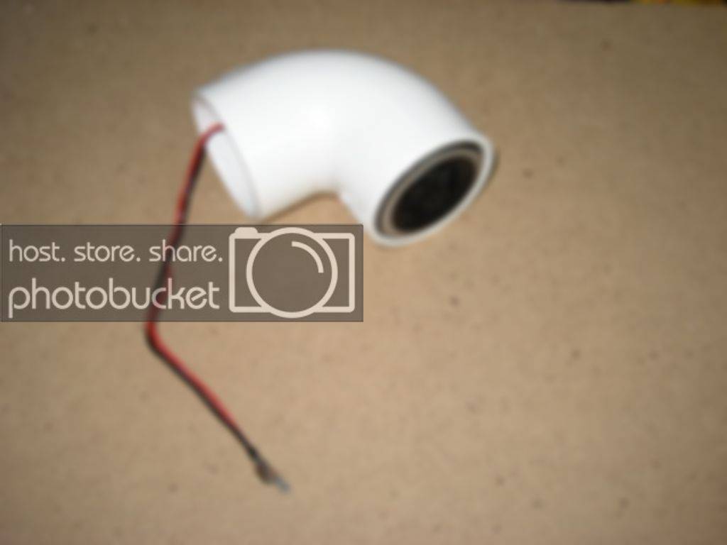

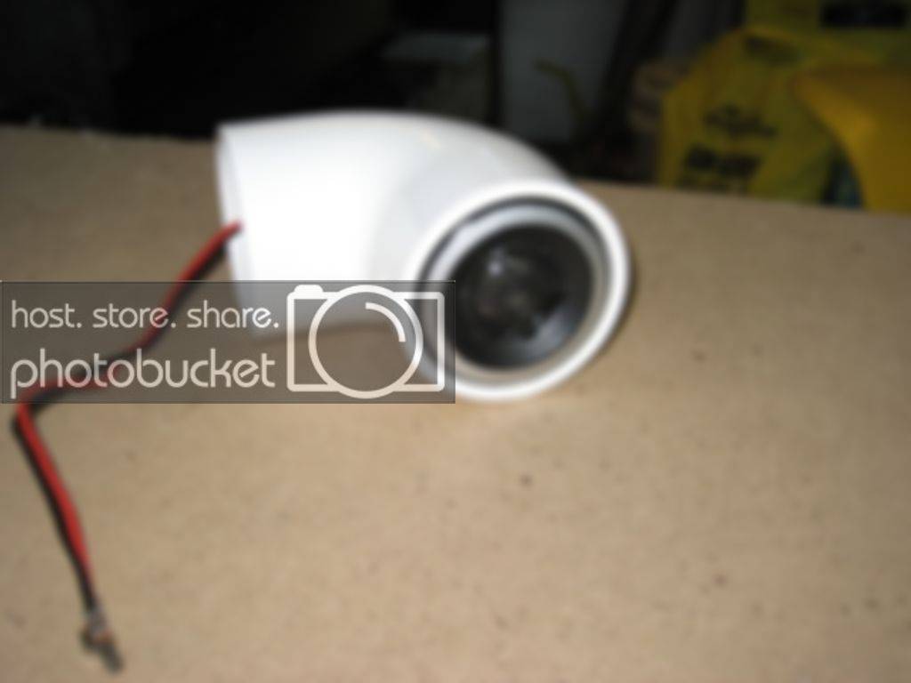

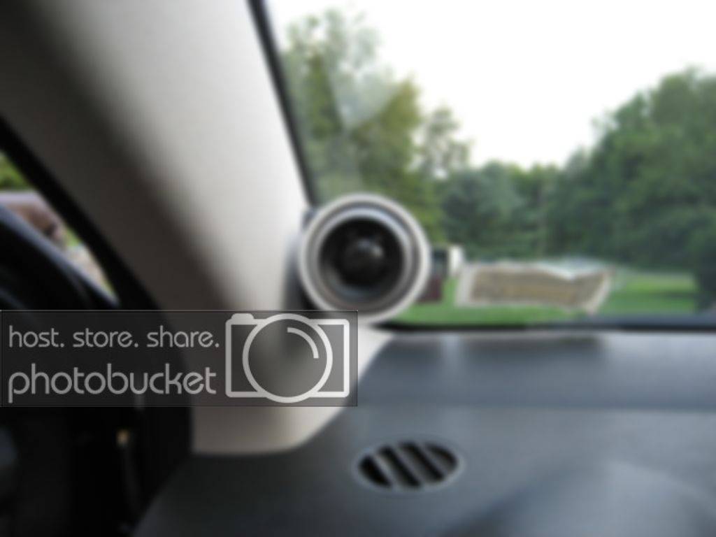

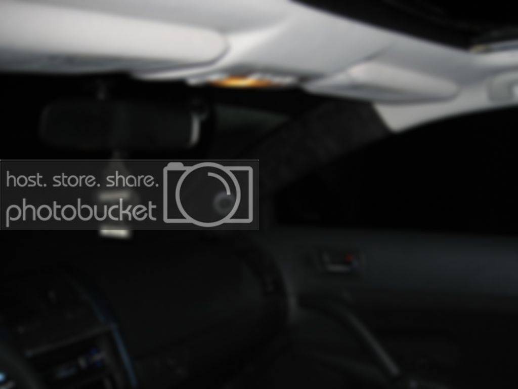

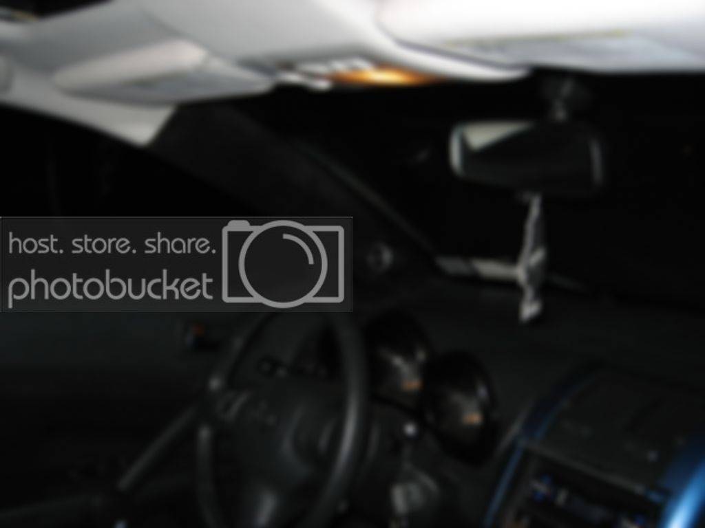

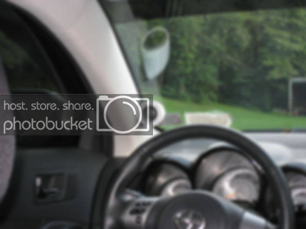

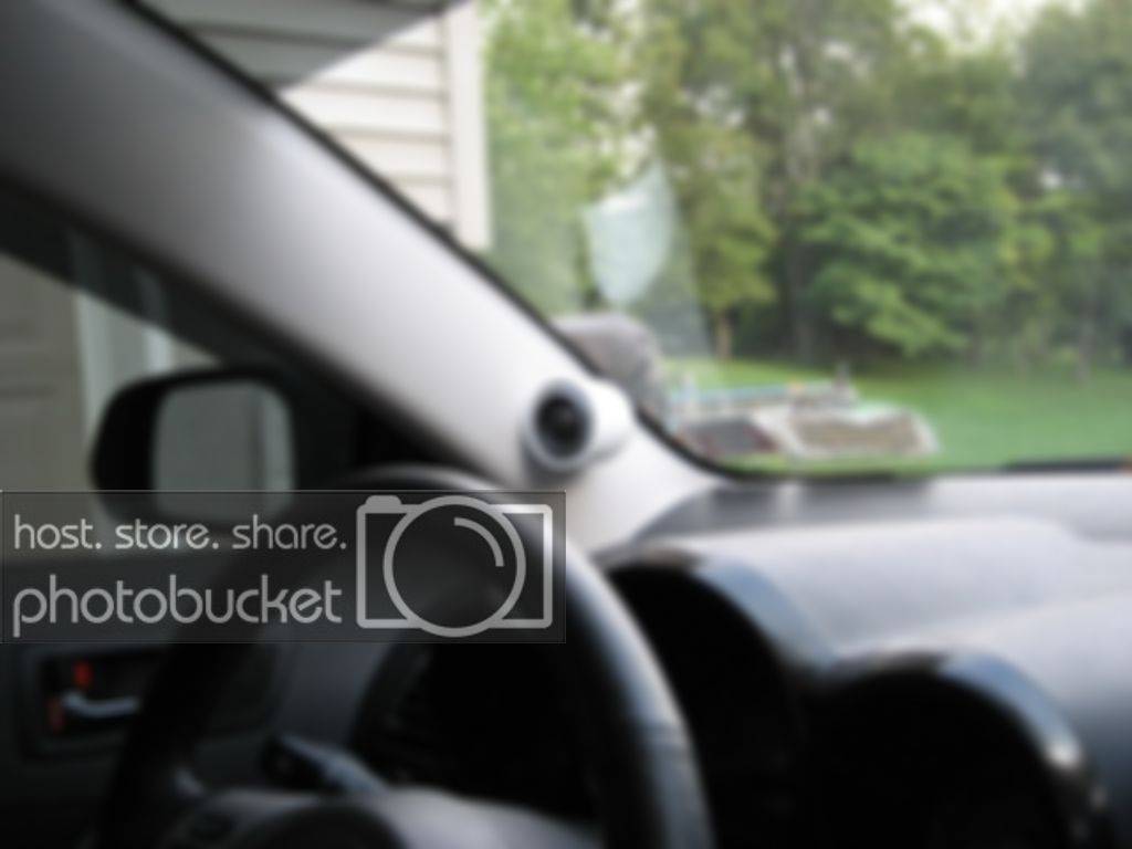

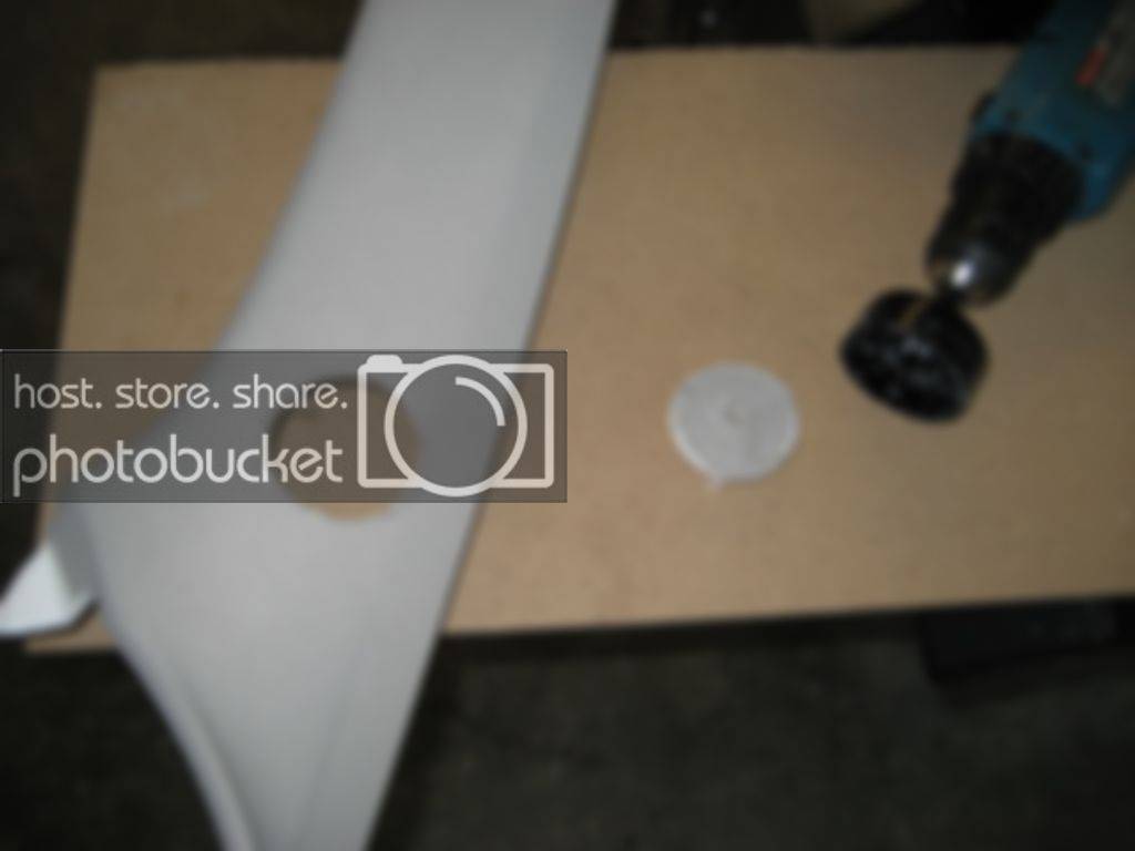

since i had the day off today and my new mids didn't show up today i figured i'd start on my pillars. they are the RSD tweeters aimed perfectly on-axis. used some pvc pipe elbow fittings and drilled holes in my pillars for the pods. as of now they are just pushed into the pillar. i am not sure exactly how i will finish them yet and the progress may be a bit slow but this is them as of now.

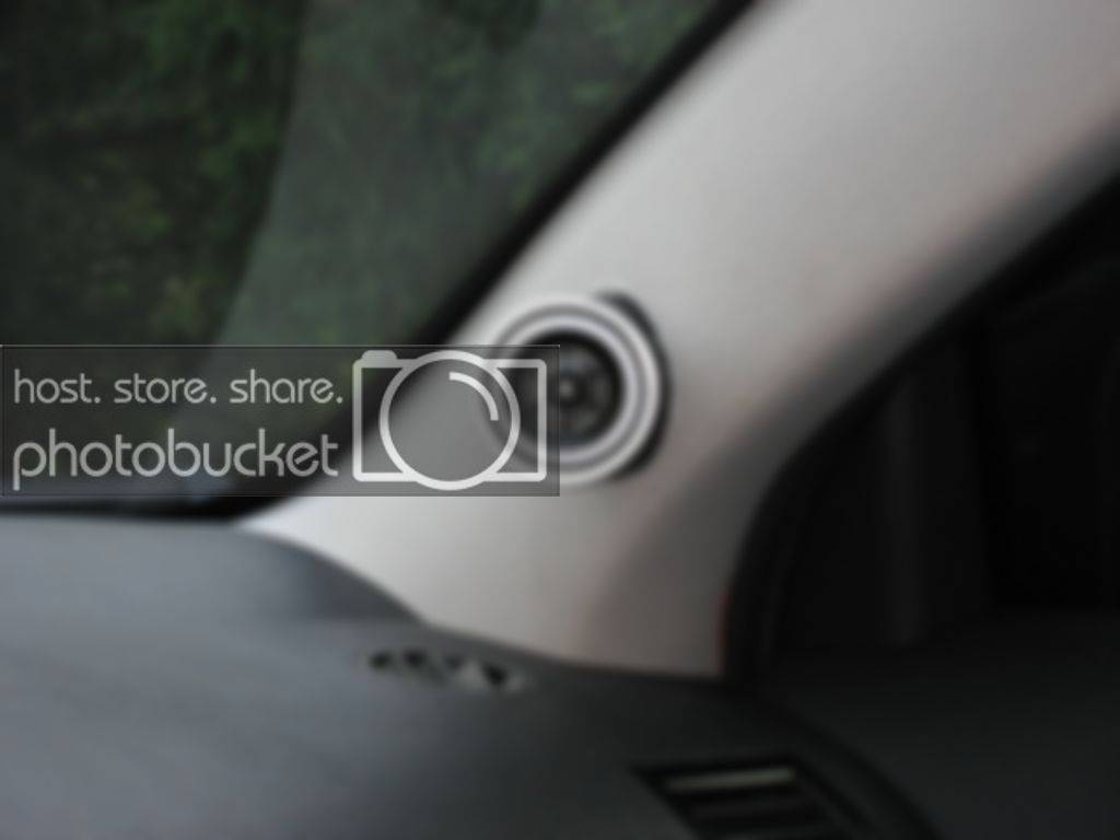

a view right from the drivers side headrest showing that the left one is indeed 100% on-axis.

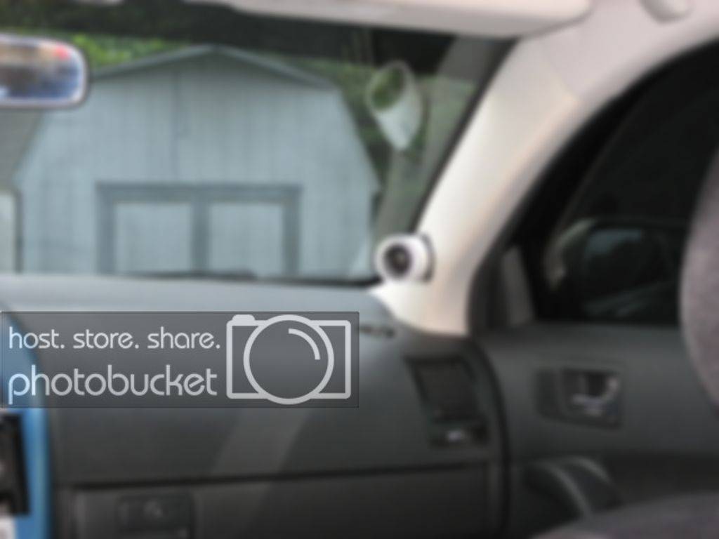

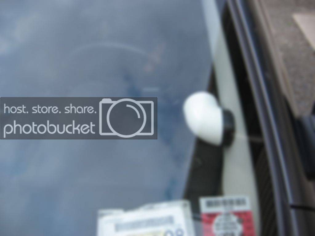

a view right from the drivers side headrest showing that the right side is also 100% on-axis.

I'm pretty new to sq but wouldn't it image better if both tweeters were directed towards the middle of the vehicle?
it's all a compromise. face them both at the same spot in the vehicle, for example the middle like you asked, and it'll image ok for the passenger and the diver but worse for the driver than what i am doing.
i really could care less about my passengers. they don't know anything about SQ anyway so screw 'em. the way i have them aimed (on-axis to the driver) pretty much screws the passengers on the top end, but sounds best in the drivers seat. if you're not competing in a 2 seater class so it doesn't matter.
if you ever get a chance to try tweeters in the pillars at various angles, try it and listen carefully. putting them on-axis really brings out the top end and adds detail. i am hearing things i have never heard before in certain music.
IMO "on-axis" is the only way to go.

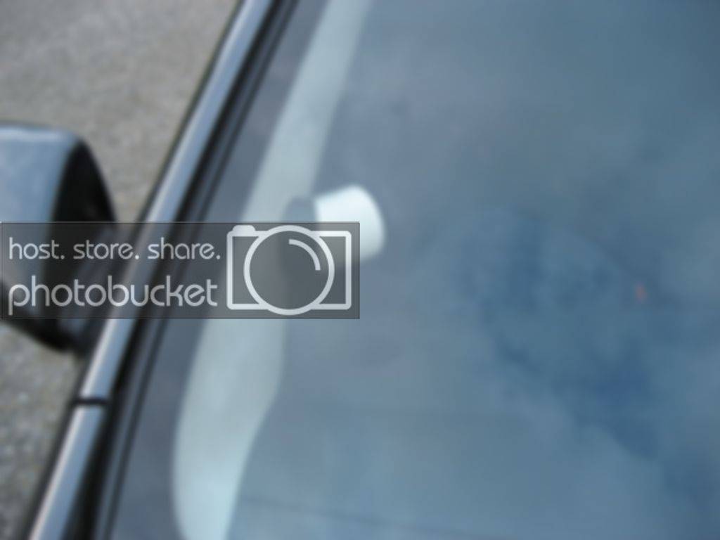

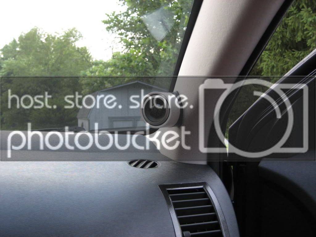

made some progress... not sure if this is how i'll leave it but it definitely looks a million times better already. also, better pics will come in the morning once i can take a few without the flash.
