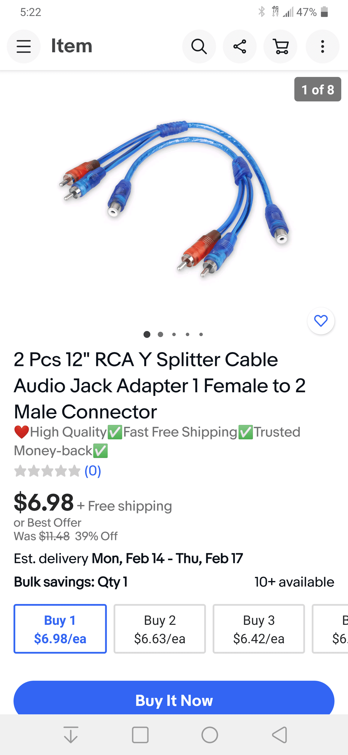

You can splice it with the Alpine using a 2 Y-splitter RCA patch cables.
Maybe one with longer "tails".
what exactly would I connect to what with those? ie. mono to the car amp to radio
First question is, do you have an aftermarket radio or OEM? If aftermarket, does it have a subwoofer output. If it has SW output, I would run a dedicated RCA cable from it to the mono amp.
If you do not want to run RCA cables, then the RCA cables that go into the front channels will connect into that splitter. The splitter goes to both amp's front RCA inputs.
