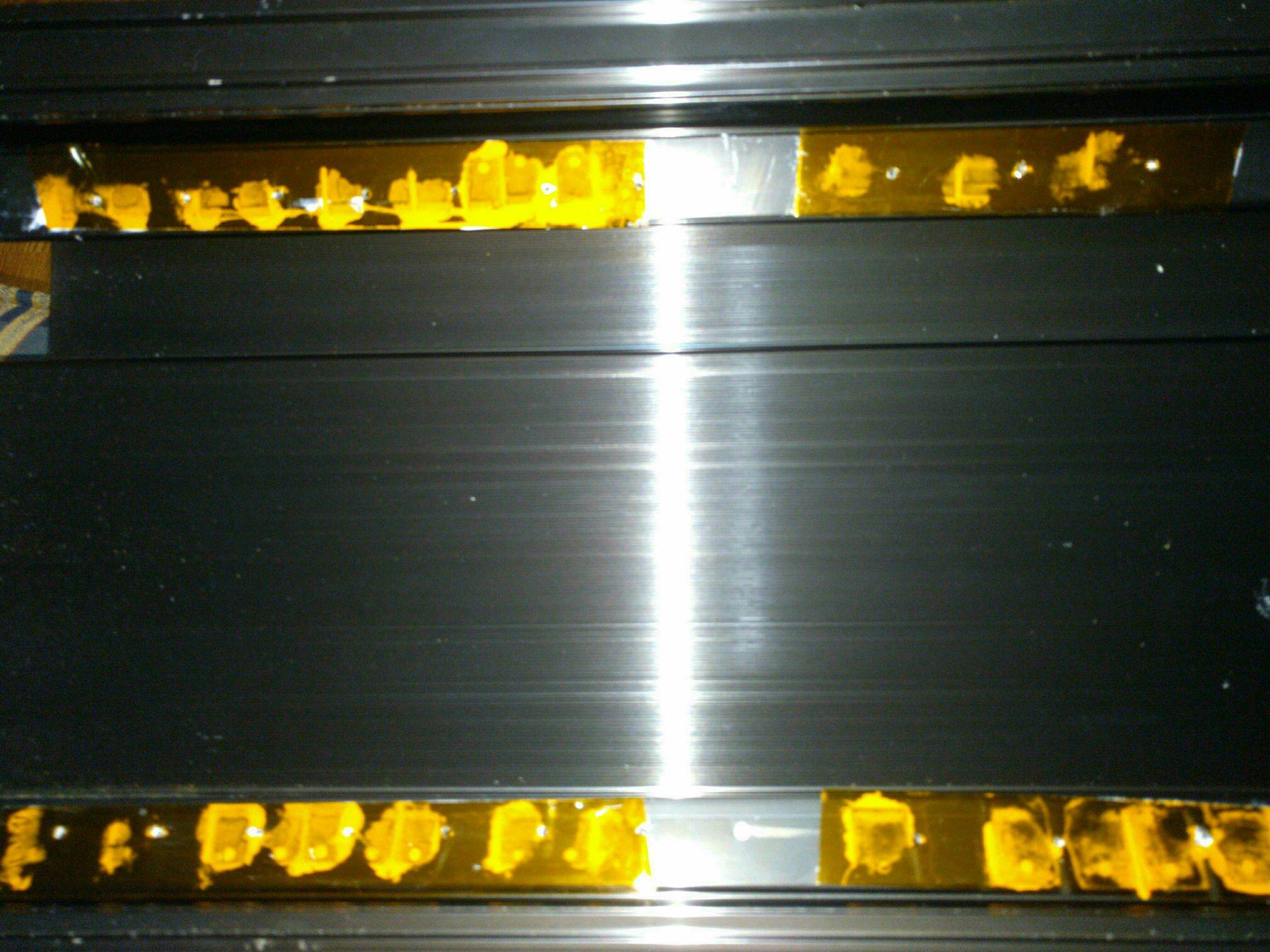

What's this?
It was under the transistors in the amp. It's a gold plastic strip that has was sandwiched in between thermal compound, wouldn't it be more efficient to bolt it directly to the amplifier? Or is this to decouple it from the metal chassis?
