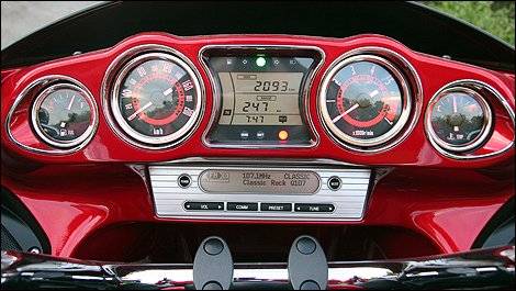

And didn't know if you had a stock radio or aftermarket one.
Yeah, Stock.
There are brackets available for an aftermarket head unit. But I really don't want to part with the OEM one. It just looks sooo good and really ties together the muscle car styling of the dash on this bike.
