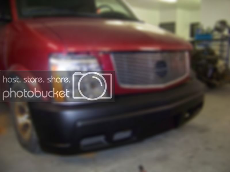

Can we move this to the Dome so I can give some honest opinions on what I saw when I clicked those 2 links?
sure but i would still like some advice on what to get. What is your honest opinion on what you saw
Ok - 1) sorry but I think that van looks horrible, I guess if you are into passing out free candy at teh middle school it would be fine.
2) The previous install was horrible, RCA's ziptied to the Power wires, garbage amps, garbage subs, garbage installation.
However, that is the past.
I can see why you want to run the same box, as it was glassed and does not look that bad. But a couple of things. First I now question everything to do with the stereo setup as the previous owner knew nothing at all. Second ported does so much more, if you want (creepy) van to really shake (hopefully while no small children are inside) ported will do it much easier than sealed.
So you really need to see how much airspace is in each chamber. You can use packing peanuts to find the volume.
As for getting power (an amp) power is super cheap these days so it is not really that hard or expensive.
Find out what airspace you are working with (and also think about tossing that box out and going ported) and it will be much easier to resommend some equipment to you.
for the click impared, here are some of the pics the OP has.
1. I'm sixteen so its not creepy and I like the mystery machine look and 2. The subs and amps came with it and as I Said new head unit rewired and getting new subs and amps (that's why I made the thread) 3. I think it'll be enough with 3 10s and if that's not enough when I get more money I will get a 2 15's box because I think they work well with 10's if im correct
Yeah, that really needs to be redone. All of it. And I really think you should look at 15's if you want to pressurize that much space. I think you will be disappointed with 10's in that van. It's a nice looking box, and I'm sure you could get some money out of it if you sold it locally to some kid. You could even use that to get them in the van. Won't even have to buy candy.
