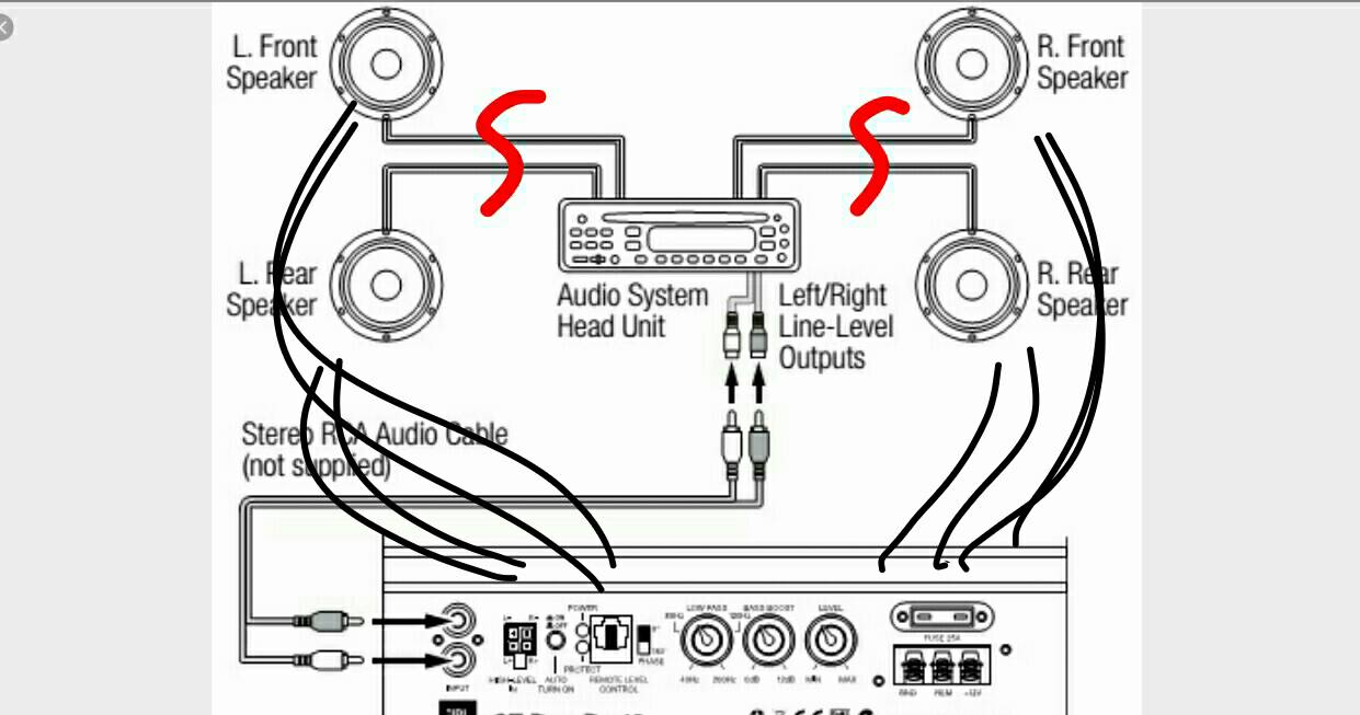

Why couldn't you split the output speaker wires from the HU with 2 double throw/double pole switches? A set of speakers on each...then mount the switches somewhere inconspicuous. Then you flip the switches for the speakers, and turn off the amp...(it would have to be on a switch too) then play just through the HU. Something like this...
The red S for your switches.
It's definitely an interesting idea.
