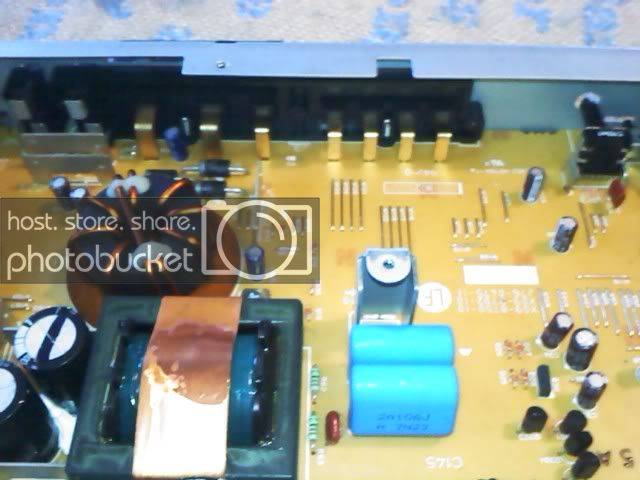

So I opened it up. At the top of the picture is where the power and everything goes in. It starts with the first brass looking prong and goes power, ground, remote, and then the 4 speaker outputs. Everything looks fine, theres no blackening around any of them or any sign of shorting. I'm hoping that this was just a bug and it goes away, but I highly doubt it will. I hate how it did this just out of nowhere last night.
