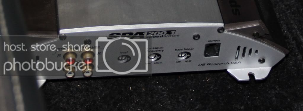

This amp has rca inputs and outputs and I don't know which is which but I'm thinking guessing on this is safe enough yeah?

You plug your RCAs into the input slot on the amp.

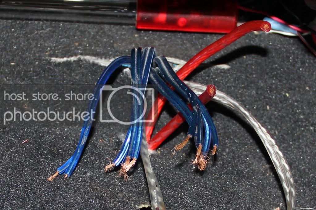

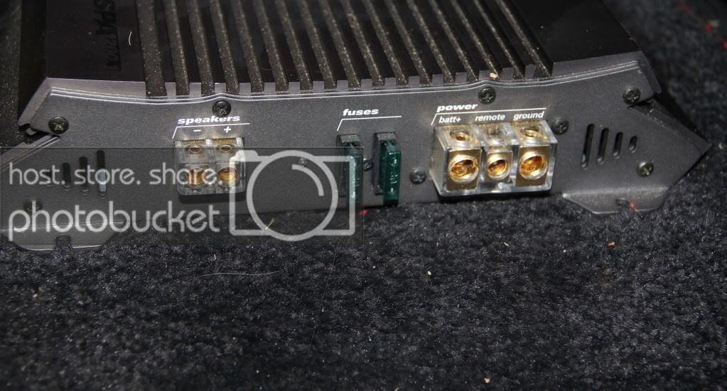

Alright here's what I'm working with. Pic of the wires, and front and back of the amp.
So there are 5 pairs of speaker wires, 2 power/ground wires, and 2 sets of RCA.

So the speaker input has + - marked... Is there any obvious way to tell which is which for the wire pairs? And does anyone know if a remote wire is required for both amps or just one?
to be honest a volt meter will be ur best bet to figure out which is which without running the risk of ******* **** up. if you connect them backwards the least you could do is fry your fuse on your power wire but i wouldnt risk it. just take the time to see where one of them leads if you dont want to buy a volt meter.

Is there any way to distinguish pos/neg on the bundle of speaker wires?
I just took a closer look at the wires. I found the remote wire afterall, it was under the carpet.
And there are 6 pairs of speaker wires in total. Makes more sense as there are 6 mids (3ea in each front door.. which doesn't cover for the one in each back door.. hmm)
Anyway, 4 of the 6 pairs have one wire marked with + signs the length of it, so that makes things easier, but two of the pairs have white lines down the length, does this normally mean one way or the other, or is it different for every installer?
I did get a voltmeter. Didn't come with batts but I can figure it out now.Thx for the remote tip.
Yes , take a AA battery and connect it to each set of wires and watch each speaker , if they suck in just flip the wires over and re connect , now whichever wire was on the positive terminal of the battery when the speaker moved upward is going to be your positive.
