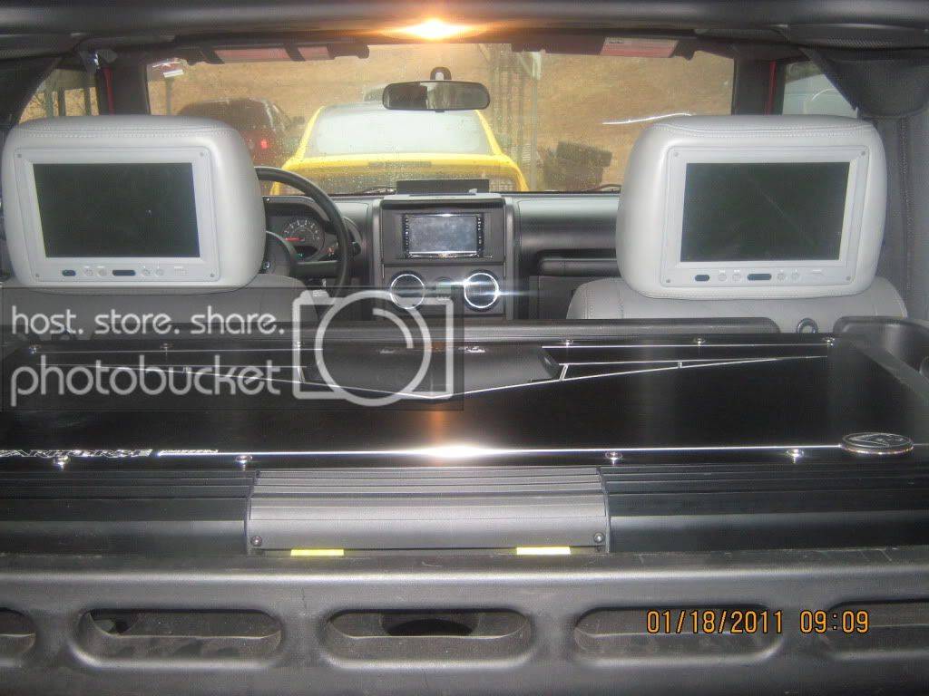

My Jeep was a 2008 ..I ran active DD components up front and modded the stock Jeep tweeter pods to hold the much larger DD tweeters ..I kept the stock sound bar speakers on radio power for rear fill but that was really too much with it mostly faded to the front ...here is one pic where I ran a 60# 10,000watt Kicker Warhorse in it to a show ..
Insane! I'm surprised your top didn't blow off with all that power bro!
