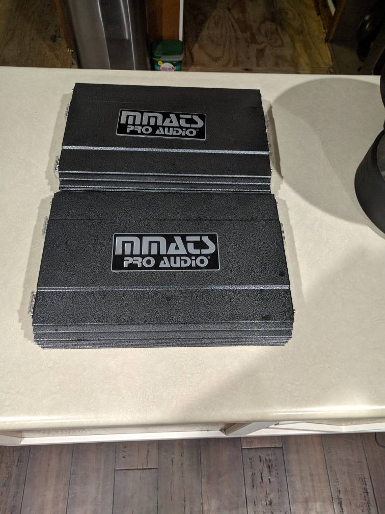

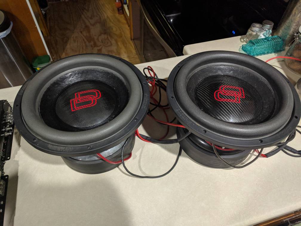

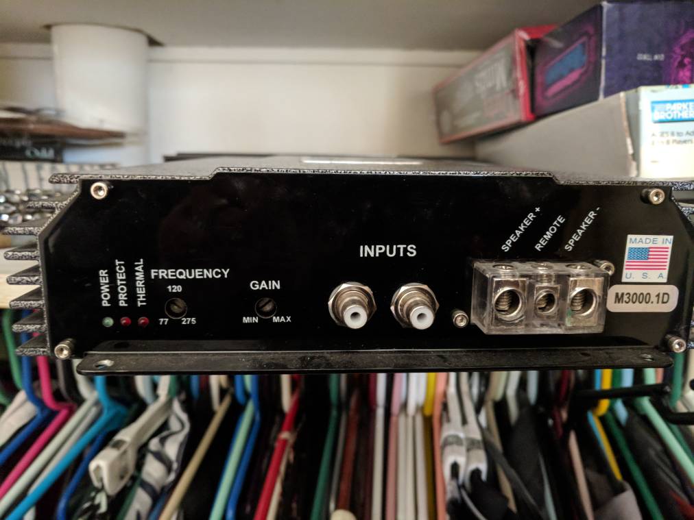

I have 2 DD 9512's 4ohm dvc. As well as 2 Mmats m3000.1. From what i read the MMATS amp is 3000w rms @ 1 ohm. and 1700w rms @ 2 ohm. The amps from what i see, are not bridgeable (only 1 rca input on both).* Are my only options to wire the subs together and only use one amp @ 1 ohm. Or to wire each sub to its own amp @ 2 ohm and gain match them.*
Are these my only options besides getting a different amp?*
With those subs and amps yes those are your best to options
2 ohms per amp per sub. Which kinda *****...I think those amps put out the most power into 1 ohm yes? If it were me, I would run one of those amps to a final 1 ohm load and either keep the other amp or sell off to buy a bigger one.

That's kinda what I was thinking. Any idea what these amps are worth?
Those amps are in nice condition...kudos for keeping them that way. As for a price, perhaps a few hundred a piece....?
Those particular ones made in FL?
Thanks! Yes they are, as far as I know. Any suggestions on a replacement amp?
Those are worth quite a bit, don't take this seriously but my best guess would be $500-600 each. I would hate to let them go if i were you lol try one at 1 ohm and see if it's enough!
