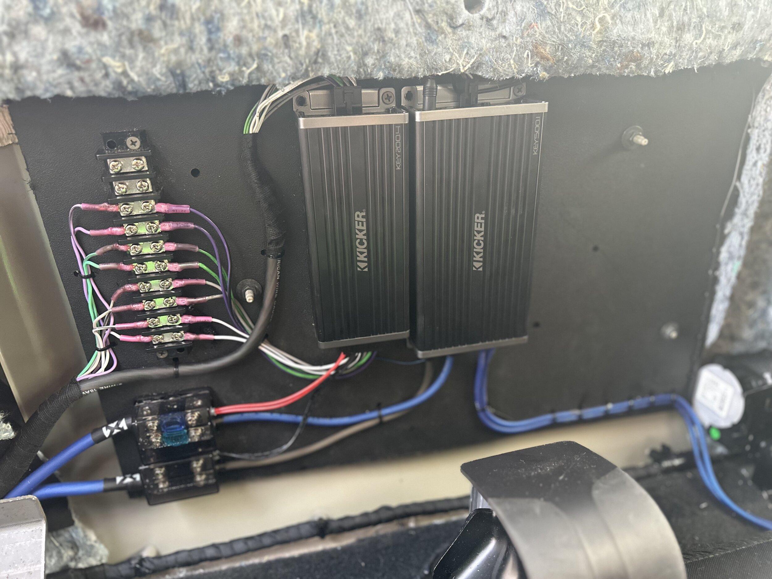

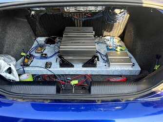

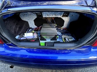

I'm about to put ~10 more build pics of it now on my thread but I will post a progress pic for those who don't follow my build. This will be for 6 amps, a dsp, and some passive crossovers. I should have it done by Saturday. I'll post another photo then.
Decided to go behind the rear seat

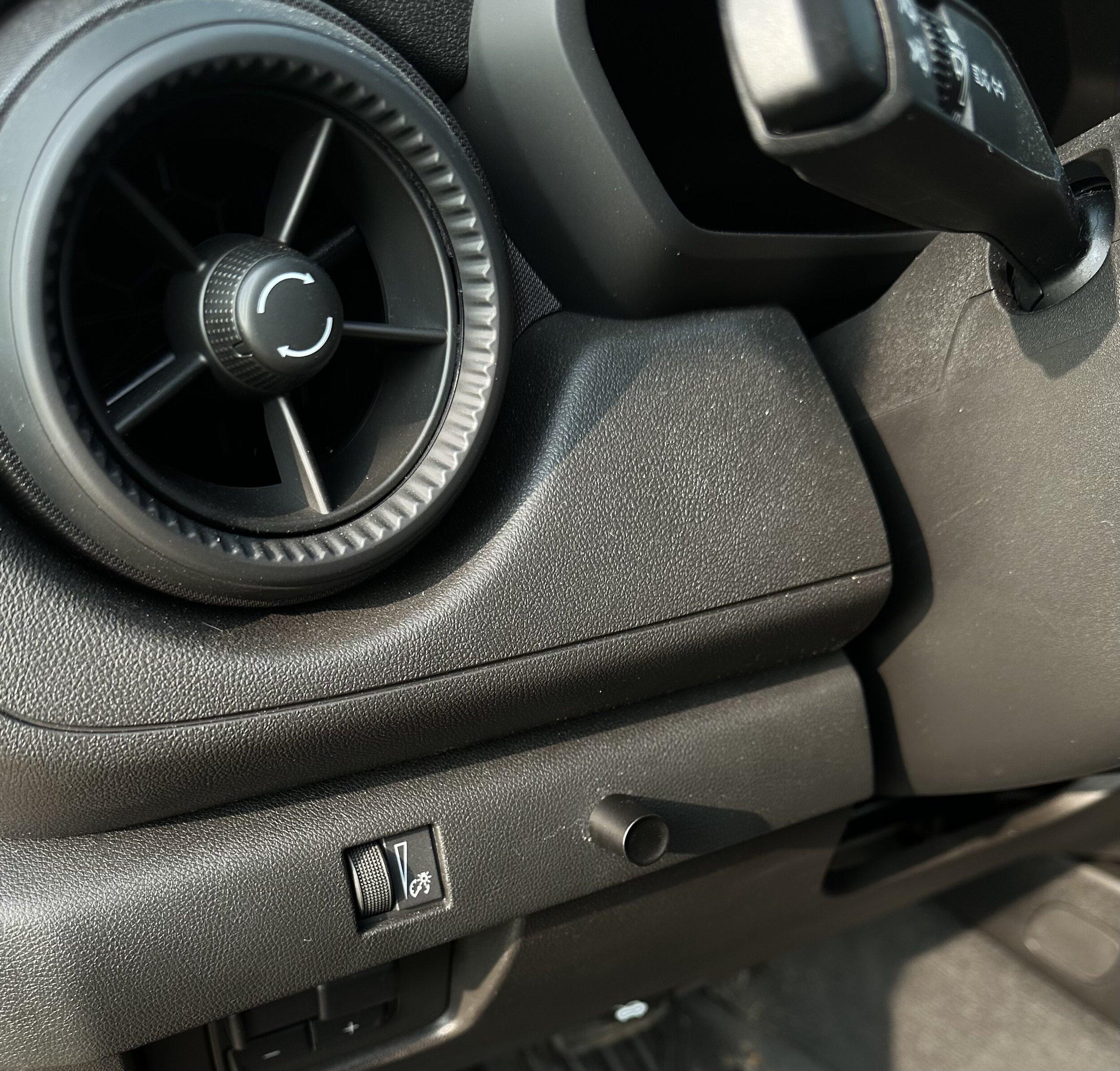

Put bass knob on dash left of steering wheel.
I gotta finish up tomorrow. These old bones can only take so much laying underneath a dash.
I took out the Rockville 4 gauge and replace with NVX 4 gauge.
Looks great. I have to mount by bass knob/DSP up front too. Crawling all over this car isn't as easy as it use to be. Closing in on 50 definitely changes you. The running and lifting helps.

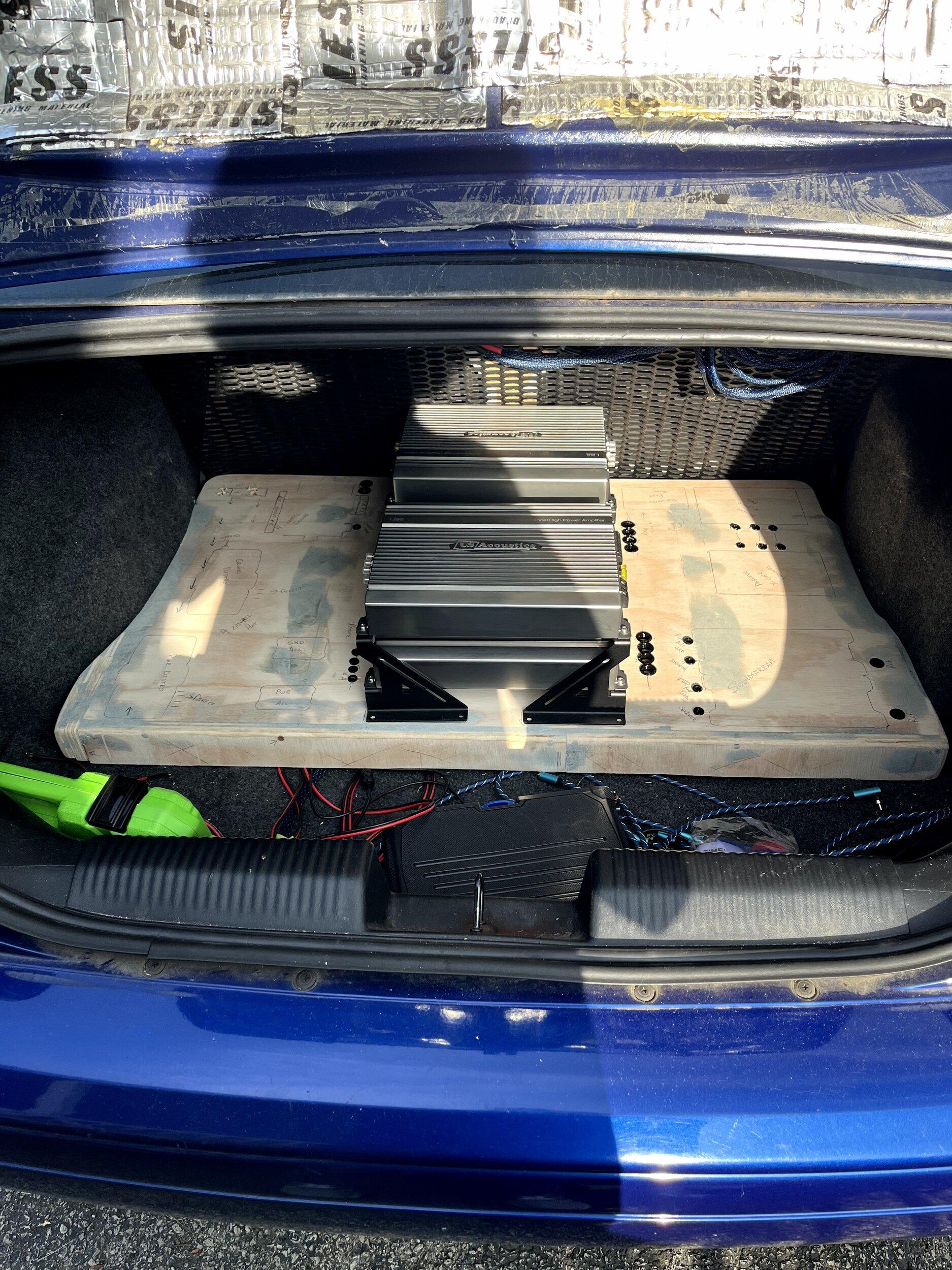

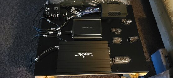

Just getting started on mine.

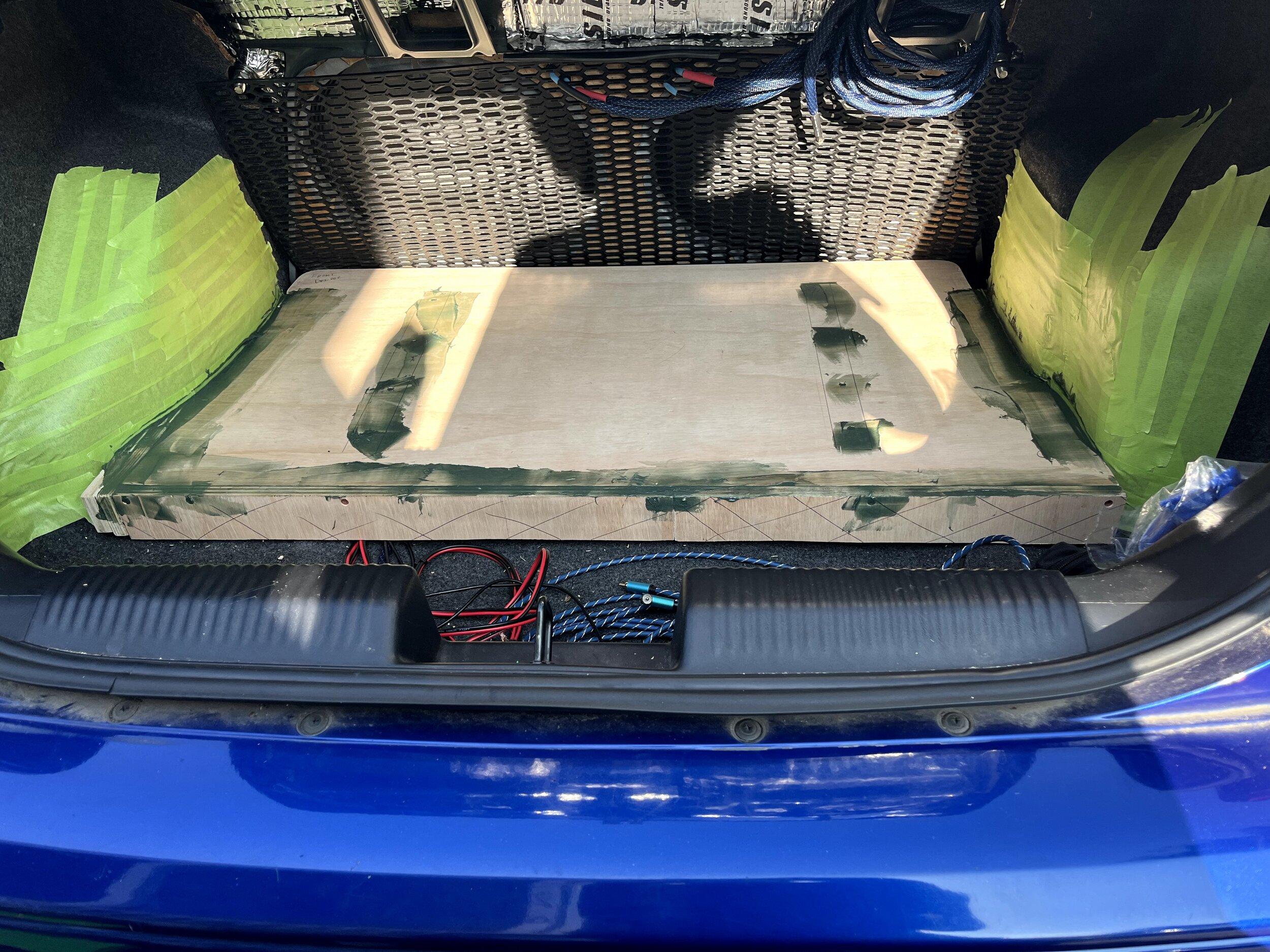

1-1/4 " Countertop piece cut to 32x24 to fit forward part of 300C trunk. Sprayed with epoxy enamel.
Need to route cables so it's puzzle time now trying to figure out cable management. Using cable claps with #10x1" pole barn screws. They already have built in rubber washers, will use to secure equipment as well. Using restaurant style heat mats they use to set hot pots on, cutting them to shape each bottom piece of equipment being screwed down will help with vibrations and strength.
More pics to come.
