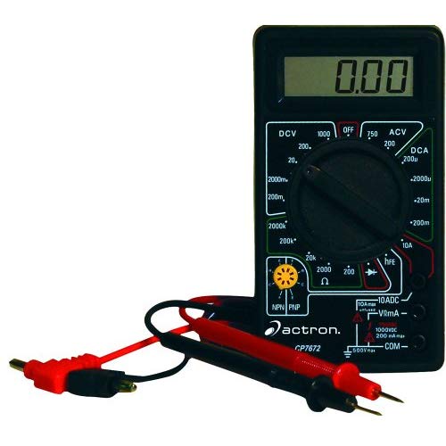

Multimeter is Actron CP7672 /// bought it from AutoZone for $20

Are you using the green area 200 to the left of the diode symbol to test how many ohms you have on the coils?

Things left to check: Remove the speaker from the amp output. Check resistance of the speaker wires (Green box, Omega, Ω, 200) Post that.
Do the same on the speaker terminals. It will start small and will increase in value. Increase the catagory(200 to 2000 to 20k (Most stop here) until you get a reading that is not 1(overload, above range selected, on most cheap DMMs). Post that here.
