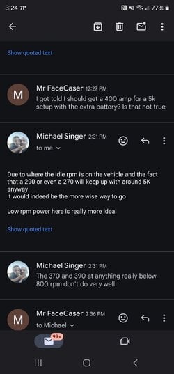

So i was told to get a 400 amp alternator for my 2012 Nissan altima 3.5 V6. There's about 5k watts rms of car audio with 2 amps 1 is sundown SIA 3500D and DS18 EXL-P1200X4. I do have an extra battery as well XS power not quite sure on the size. So I hit up singer alternators and he said I only need a 240 or 270 amp alternator as it will keep up with 5k watts rms. Here's a picture of the email he exactly said. Just want to make sure I get the right thing.

Mike builds alternators for a living and has done car audio for 20ish years. I would listen to him. Like he said these big alts don't do crap at idle. On a daily driver that is pretty important. Also you are not running 5k clamped. You don't need a 400 amp alternator. Do the 270.
