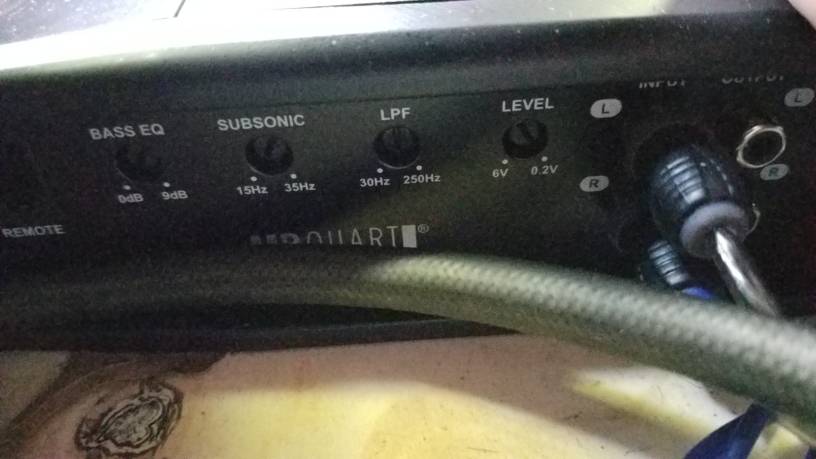

Ok, first time using a mb quart amp. Does the Level look normal? Never seen it go from high voltage to low voltage.
Sent from my SM-G955U using Tapatalk
I'm new on the forum but I can jump in on this. Some amps label the gain this way, it's referring to the expected preamp voltage. If RCA voltage is 5V, you'll obviously need less gain than a 2V signal. It's probably a better way to label the gain, in my opinion, because it more accurately describes what it's actual purpose is.
Sent from my SAMSUNG-SM-G930AZ using Tapatalk
yeah it's fine just set like normal, use 50hz tone with meter set volts to watts u want (make sure amp does watts u set it for fyi mb quart does not even come close to doing ratings., look at the crunch 1500.1 that tested 323rms 2 days ago.. made by same company)
One or two, they are still subwoofer outs and are mono summed signals from both left and right. Even the 2 RCA subwoofer pre-outs on the 2nd one...
