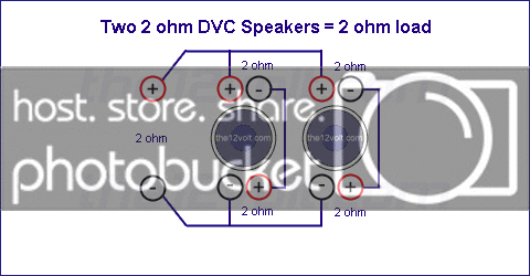

for your setup, if you so choose to go with the CVR's :crap:wire them like this:
(series/parallel) = 2 ohm load
Voice coils wired in series, speakers wired in parallel
Recommended Amplifier: Stable at 2 or 1 ohm mono
Make sure you get the 2 ohm versions of the cvrs that way you be able to get a final impedance of 2 ohms. and then your amp will be able to put out the 700 watts rms at 2 ohms.
