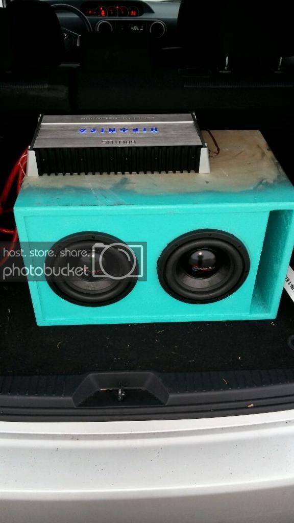

man, I got nothing but good things to say about these subs, louder than my sa8's, hits the low notes with authority, way under rated....
tuned to 32 hz......
and i got those facing in and a single 10 in the trunck and they marry very nicely, I'd give it a shot.....
