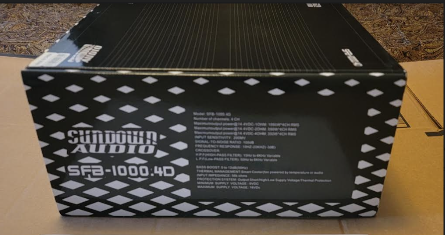

Got a Sundown SFB 1000.4D, BNIB $350 for a start.
NVX 6.5" "X" Series comps and matching "X" series Coaxials $225 BNIB shipped. Tweeters in the dash, 6.5's in the front doors.
In the rear doors.

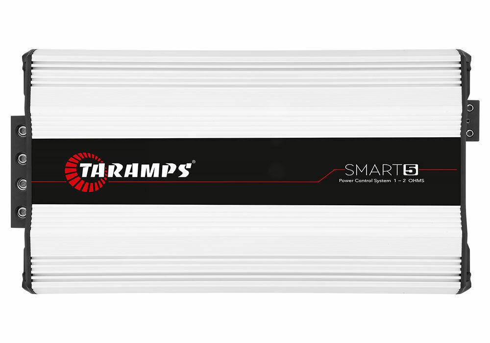

Taramps 5k
That is a nice sub, but a bit spendy. But here is a great box for it.
