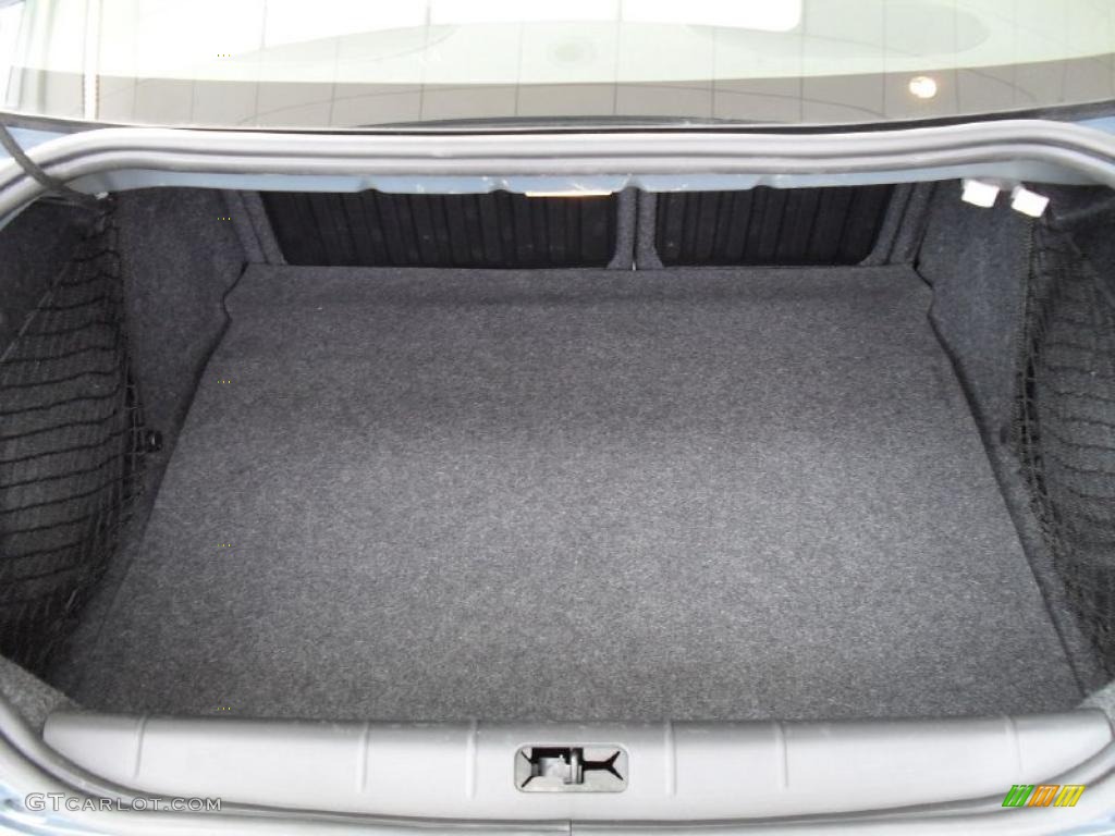

@dbeez said i dont have enough space for the 12s to preform to there best. 13t,32w,32d is my space wall to wall if i go through the backseats. said 10s will do better

you have the coupe, not the sedan, i take it?
your trunk..
and mine...
same size. Mine fits a 4^3 net enclosure thats 16.5"h x 20.5"d x 36"w.
Barely gets in through the trunk opening, but gets in. Without a prybar, lol.
edit: also fits inbetween the trunk lid hinges. thats important, too. I honestly believe this is the largest box that can be built outside the car and then installed.

what my idea was, build the biggest box possible and put it in through the back seats. 13 inches tall, and make it as wide and deep as possible..what you think

you can get a box, with the dimensions i listed, in through the trunk. You won't want your amps the way i have em, though. This week(while I'm lining my whole trunk with Audiotechnix //content.invisioncic.com/y282845/emoticons/wink.gif.608e3ea05f1a9f98611af0861652f8fb.gif) I'm mounting them to the back of the enclosure, and moving the enclosure a couple inches toward the rear.
