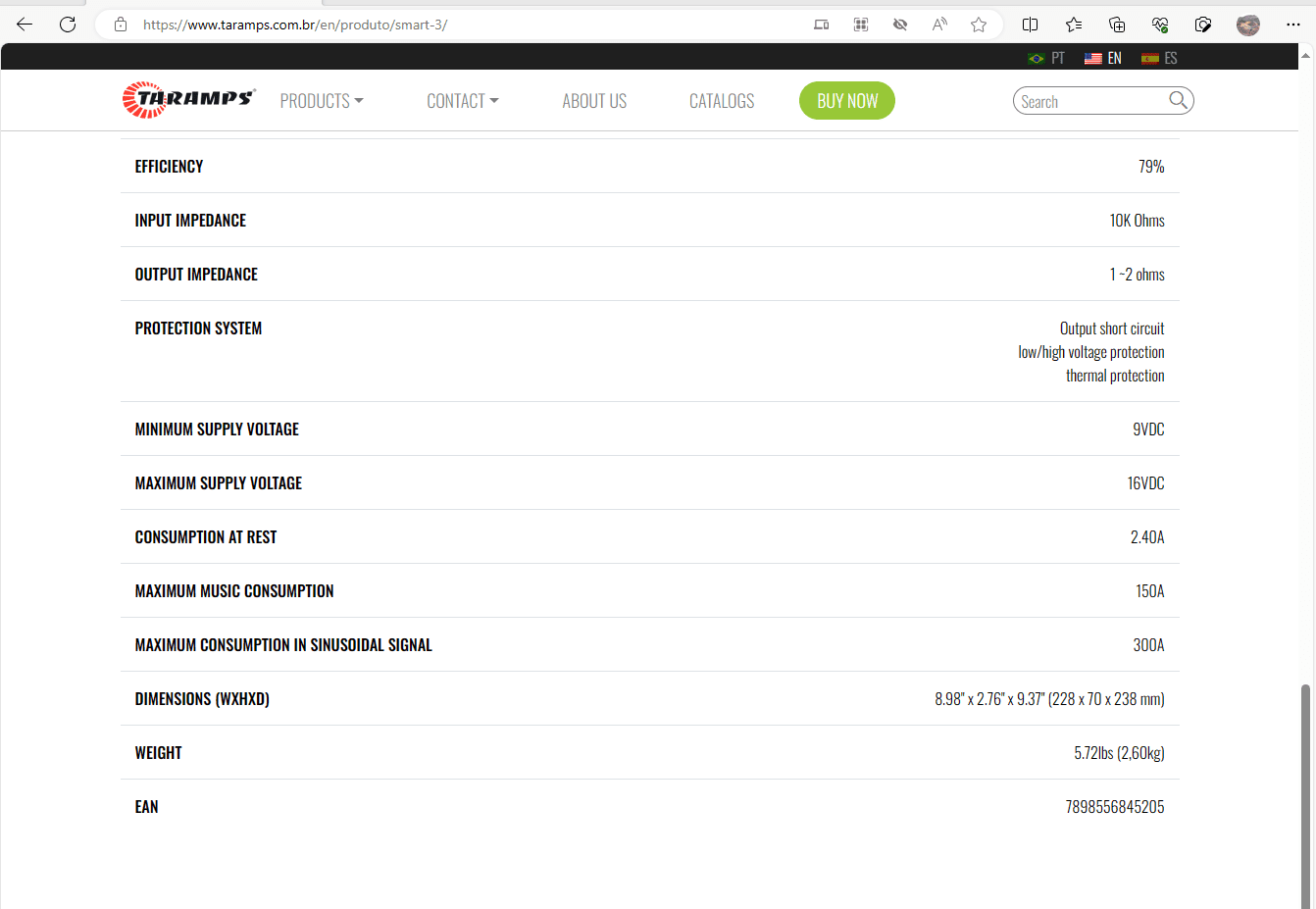

If I am running the following amps, what size alternator do I need?
Vehicle is a 2021 Jeep Wrangler
Amp 1 - Teramps Smart 3 (3k watts will possibly be running an FI Neo 3.5)
Amp 2 - US Accoustics Barbara Ann (700 watts to fronts)

You will never draw 320 amps of current for your 3700 watts.
I ran a 2500 watt amplifier with a 60amp fuse for 2 years.
Now I'm at 3500 total watts, I have a 150amp alternator and a 80AH AGM. My voltage stays above 13v.
I say run your new equipment and see how your voltage does. You might find you don't need to upgrade anything.
That's not the way Ohm's Law works.
320amps is based on the amps producing 3700 watts.
an amp efficiency of 80%, &
voltage of 14.4
What part of the math do you have a problem with?
- If you have a problem with the math, then use complete thoughts and discuss. Otherwise you're just saying no, claiming BS, and contradicting Ohm's Law.
Here's the smart 3 that requires a 300 amp fuse.
You could put a 10K watt amp in there, and if you're only using a 60 amp fuse, then at 14v you're producing less than 840watts.
