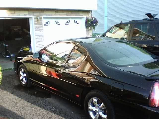

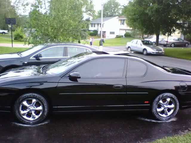

my speakers worked right after i found another power source.. before that NOTING worked.. wouldnt even turn on.. I must say it sounds ALOT louder and better ran this way, instead of thru the shitty door wiring and the crapppy factory amp... pics of ur monte?
ot that u care but heremy monte
