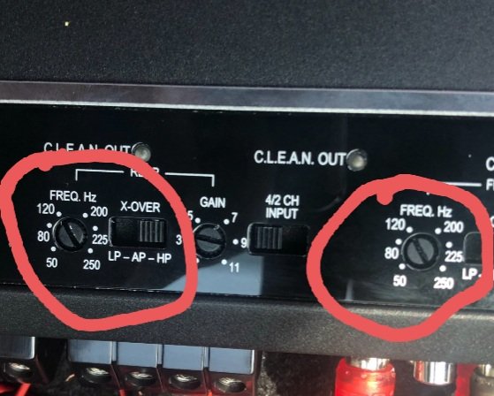

i’ve fixed the harshness problem now i’m just working on tuning them to sound perfect to my ear. my issue now is on some notes the bass in the door speakers would start to distort even when i have it all the way down on the equalizer. Should i mess with the cross overs on the amp such as gain and the eq?
set the eq to flat, raise the crossover point for your mid all the way up. play some Bass Mekanik turned up as loud as youll ever listen to it or until it starts to sound bad. then, slowly start lowering the crossover point until its too low, then raise it a hair
you gotta play around with it until it sounds best
80hz is a good starting point
