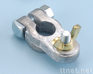

My favorite terminals are marine terminals.. theyre cheap as crap, easily disconnect and are much much stronger. They will outlast your car more than likely.
They look like this.
Their what Ive used on all of our cars including mine.
