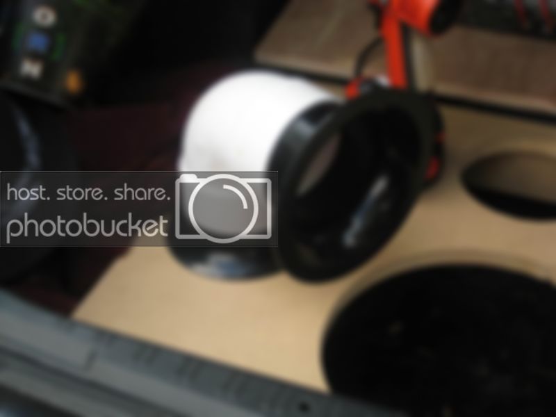

I am using an 90 elbow on my new install i am working on. as long as the joint inside makes a smooth transition it will not impose a big problem. I had emailed psp about it. also to measure the length you will need to measure down the center path to get the correct distance or measure the lengths and average em'....but the first one will be better.
I got my elbow from Home depot for like $2.xx. they are cheap. i used a 4" elbow. its 4" on each side the diameter. i almost accidentally picked up one that was 4" on one side and 3" on the other, just be careful you get the right one.

haha shit. i should of read megalo's post before i made mine. mofo has a picture and everything.
Megalo: so the psp ends fit just fine on regular pvc pipes? some people said they sizes a just a little bit different so you cant get them to fit without some work. yours looks like you just popped it right in like i was designed for it
oooh. thats a nice one. so long as its smooth on the inside, you are just making it easier for your self in the long run.
i am really interested to see if the psp ends will work with regular pvc pipe without sanding or anything like that.
