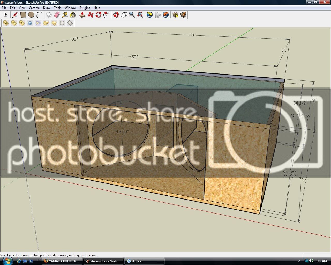

Not sure how to add it up and get ^3, 2 x 15 RE SX'S. He wants it tuned to 32hz. Got the speakers 45o angle like he wants it. Going in a 97 Chevy xcab that has a cut throu. Whatcha think?
You find volume by one shape at a time, then add all the shapes together to find the sum of all the shapes..
Volume of a Square/Rectangle = Height x Width x Depth / 1728
Volume of a Right Triangle = Height x Depth x 1/2 of the base.
Add the two together and Wahlah. //content.invisioncic.com/y282845/emoticons/smile.gif.1ebc41e1811405b213edfc4622c41e27.gif
-Bill-
No need to break it into pieces like these guys are saying. Right click on the floor of the enclosure and then select area -> selection. This will give you the area of the bottom of the enclosure. From there, multiply by the height and then divide by 12 if the height is in inches.
Just like in these pictures:
You may need to block off the area that is below the port as your port doesn't touch the bottom of the enclosure.
